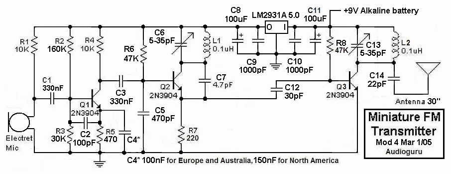

hello,
can any body help me with the schematics of a wireless speaker.
i am designing an amplifier system for my class. The schematics should comprise both the TX and RX.
The idea :idea: is to put the transmitter(TX) section in the output of the amplifier while the receiver goes to the loudspeaker.
Please guy, I need the schematics urgently to finish-up my design. :?
A radio transmitter and radio receiver are complicated, how much of your design have you completed? The receiver will also need an amplifier and power supply for it to drive a speaker.
Just attach empty project boxes to the amplifier and speaker and sneak some wires between them.
Why bother to build a receiver? Buy one - an ordinary radio.
Then build a transmitter. Audioguru has put diagrams of these in this forum.
thanx for replying. the pre-amps, amp section, the power section are all ready. the amplifier system had been tested already usind wired speakers.
please, want I want now is that wireless speaker section.
can any boby help me out.
To audioguru: David said that you have put a related diagram concerning mine in this forum. please where can I find it.
Here's my FM transmitter circuit again:

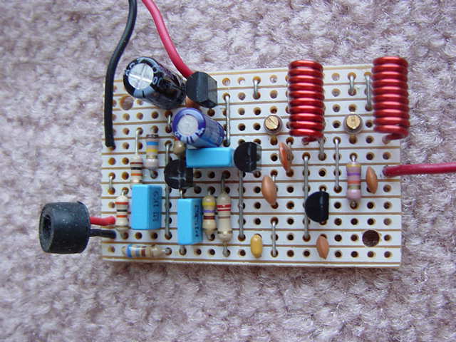

Here's what it looks like:
You have FM radios in Africa? :lol:
Phone an FM radio station and ask the engineer if they broadcast with North America or Europe pre-emphasis.
I would go with Europe, it's only North America who like to be different :lol:
I still say that North America invented FM broadcasting. In order to reduce hiss and since sound reproduction equipment in those days didn't have extended treble frequencies, they designed pre-emphasis that is excessive. When the Europeans finally got around to planning their FM broadcasts, microphones, speakers and recording equipment improved enough to show that less pre-emphasis is best.
