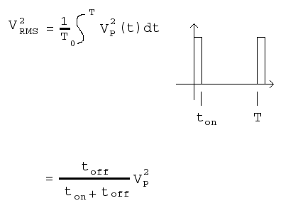

A pulsed solution may be a great boom to help with the costs and weight. Where as the poster above speaks of 100 amps in a 1 second burst...
The couple things specifically I would love to know ... how can you tell the approx max current you can get through a wire for a short burst.
After the burst is there a way to calculate the heat dissipation or even an approx time between bursts that would still not damage the wire... 5 seconds? 30 seconds? 5 minutes etc.. Since the field will be used for a projectile it doesn't need to be active for much longer than a second.
I haven't been able to come up with anything on this, so I'll "wing it". The values for the current-carrying capacity of these wires are either DC or RMS values. So I figure that one should be able to figure the current pulse on the basis of its RMS value. The lower the duty cycle, the more current you can pulse the coil with.
If the RMS current is 32.0A (selected previously) and the peak current is 100A, then:
t(on)= 1.0 sec
t(off)= 8.77 sec
This will give you an RMS current equal to 32.0A DC or sine wave RMS.
Of course, the next problem becomes forcing the necessary current through the coil's inductance.
Hope this helps.
