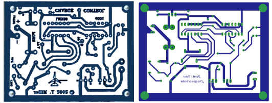

Here is a side by side comparison of the original VS my copy created in Eagle layout editor. When I created it, I first drew out the schematic in Eagle and then placed the components on the board view as close to exactly the same as the original. I did a side by side comparison before I etched the board.
I had originally tried to use the image that you (tytower) have shown, but to get the pin spacing exact was a pain. Not to mention the original image was quite blurry when blown up, so to try and get traces that didn't overlap or other issues was going to be a pain. This is why I decided to use Eagle to make as close to an exact copy of the original as possible. I manually routed the traces in Eagle instead of using the auto-router so I could trace them as seen in the original. The only thing I missed in mine that the original has was pads for the touch points A and B, but I was able to add those to my board without too much trouble using some 12 gauge wire.

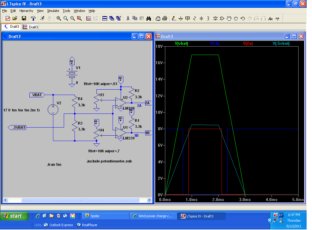

Window
Here is the simulation. Are we saying the same thing?
Your simulation looks correct. In your sim, your 2A would be the U2-A output and your 1B would be the U2-B output. The graph is showing 2 windows of the circuit. The windows are when both outputs are low at the same time with the first being just below 1.0ms as the voltage (Vbat) ramps up, and the second being just above 2.0ms as the voltage (Vbat) ramps down. The problem I have with my set up is that U2-A is high (8V) at all times, where according to your simulation it should be low below 14.5 volts. My U2-B is fine and will stay high at anything below 11.8V and low at anything above that.
Your lines under the 4001 are very close
I scaled down the image a bit before posting it, but I did do a continuity check on all traces on the board and made sure that I do not have any cross connects or solder bridges. I inspected the board also under my magnifier and all looks good.
When looking at the two board layouts side by side they look correct to me, but when you stare at something for too long you can miss things, so having another set of eyes check it out might help. Do the board traces look correct?
