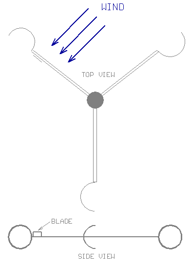

The mechanical part shouldn't be difficult at all. Use three (balanced) arms with halves of ping-pong balls.
Using an optical sensor you can even measure wind direction if one of the ball carriers is fitted with a small blade.
Downwind that arm will acellerate and upwind it will decellerate. The "zero" point determines wind direction.
Boncuk
