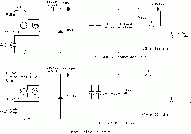

Hi all...
See circuit below:
If I replace the bulbs with a 12v 2a transformer and use a 12v panel lamp will this circuit still work?
I'm trying to build this circuit and get away from using those damn big bulbs =)
I want to have this all inside a neat project box.
Thanks alot...
Jim E.

No, the lamps are being used as a current limiting device
Lefty
Thanks for the fast reply...
Is there any way to get around using the bulbs?
Can I use a Ac to Dc wall adapter??
The 150V capacitor will blow up in that circuit because it will have AC across it but it is polarized.
Replace the big bulbs and the 150VF capacitor with a power resistor. Connect a 12V transformer to the mains by itself, but the 12V light bulb won't dim when the photo-flash capacitors are charged.

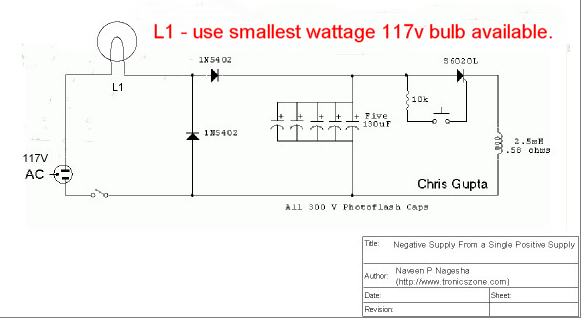

You might try this, no guaranties:
https://www.pbase.com/sinoline/image/84010427.jpg
If the photo caps doesn't charge fast enough use larger bulb.
A 120W 110V light bulb is 101 ohms when hot and about 10 ohms when cold. The average is 56 ohms. Try 56 ohms 25W.
A small night light 110V bulb is only 5W. Its resistance is 2.4k when hot and about 240 ohms when cold. It will charge the caps very slowly.

The 50 ohm 25 watt resistor will have 300+ watts applied to it when the capacitors begin charging. Keep the duty cycle low.

But isn't it supposed to be a voltage doubler?, so it needs the first capacitor.
You are absolutely correct! I missed the voltage doubler.
Then the 300V photo-flash capacitors will blow up with 310VDC to 340VDC across them.

Don't PC power supplies switch electrolytics as a voltage doubler when set to 110V?.
You all missed the 1N5402 diodes which have a peak reverse voltage
of only 200 volts, 1N5408's are more suitable for this purpose.
on1aag.
I disagree, the capacitor won't blow up as worst case it only conducts current the wrong way for half a cycle and even then it's in series with C2.
Thie only probelm is there needs to be bleeder resistors to discharge the circuit when it's disconnected. I'd be even tempted to install a relay that shorts the capacitors via a bleader when the power is disconnected.
