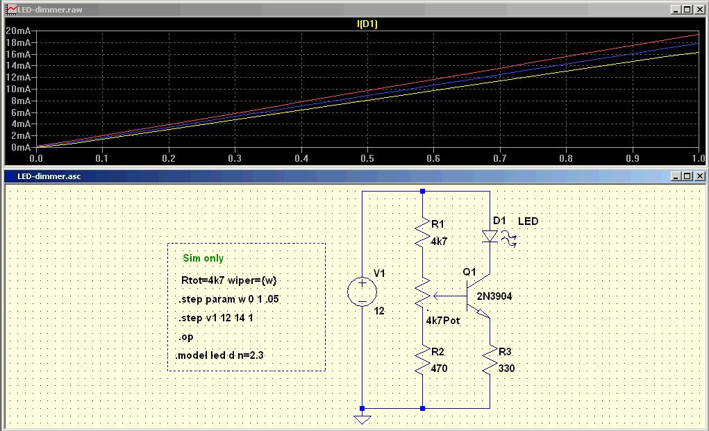

The schematic is indeed helpful. Now we know that the pot is volts-free if disconnected from the ECU. We can work from there and come up with a solution for indicating wiper position. But apart from dimming a LED you will still need some way of switching the motor current off when either limit of travel is reached.
Here's one possible LED brightness control circuit, but it may not be suitable if you also intend using the same pot in a servo loop to control drum/valve position proportionally.
The three curves show current variation with pot wiper position and supply voltages of 12V, 13V, 14V.
