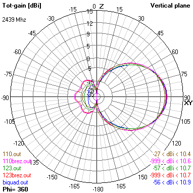

4pyros, Cantenna's will outperform Yagi's and have a simpler construction. Biquads are a good choice as well because they're flat.
https://www.engadget.com/2005/11/15/how-to-build-a-wifi-biquad-dish-antenna/
Note the clever use of a used satellite dish to further increase gain. The dish is not required you should get a good 9-12db of gain using just the straight biquad. Cantenna's will do the same but the dimensions of the can are actually quite important, and finding a can with the perfect diameter and proper length is not that easy.
Just a quick note, don't skimp out on the wire you use, the bandwidth of the element is affected by the thickness of the wire, so the thicker the better.

Yes, Biquads are HIGHLY directional, at 15degree's it's no better than a dipole, around 3db gain, at 90 degrees (directly facing it's target) the gain is almost 12db. ALL atenna designs have to sacrifice gain for directionality, they can not create power they simply focus it. Double Biquads are supposed to a few db better, but I think construction techniques are critical when you're talking about that much gain.
https://www.lecad.fs.uni-lj.si/~leon/other/wlan/biquad/index.html
