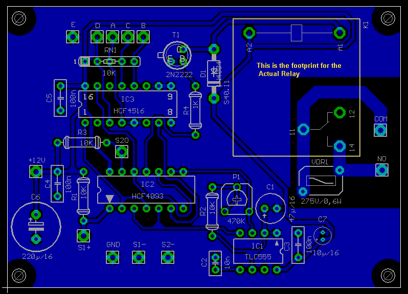

Is there anybody to explain me what is a "FootPrint" in PCB field plz?
Its the component outline, the area which the component covers over the PCB face....
Sorry Eric, But can yuo show me it by a pic plz?

hi
This is a PCB laid out by 'Boncuk' I have marked the outline/footprint of the Relay in Yellow.
Thats the board space the relay occupies.

hi
Thanks a lot Eric,
It makes sense. So the footprint or so called PCB package in proteus software is the pattern or the demantions of it where I see in the pcb window. Actually the components in the PCB window called footprints, righ? But if we call it as the area occupied by the pins of the pcb components then plz let me know if it is just the pins or the complete area under the case?
