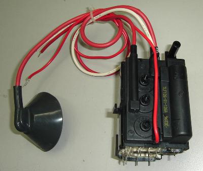

I made the circuit below, and it worked perfectly......but just once out of 10 times... I would get some sparks, and then it kinda look like it turn off and doesn't work for a while for no reason. Sometimes it works 3 times in a row, sometimes nothing. The connections seem okay, the polarity seems fine also since it already worked. So basically I just don't get a whine or a sound everytime I put my power supply on.
I'm using a new flyback (picture below) with a MJE13009 transistor. The transistor seems fine also, doesn't even need a heatsink. I don't if there is any kind of capacitor in there so it has to discharge or something. Can you guys help me with this ?

OK. I have time now to try and help clear up exactly what you are trying to do.
You (as per the attached photo) are trying to use a Line Output transformer from a CRT TV to generate high Voltage from the Anode of the transformer.
No problem with that. TV Line Output Transformers typically run at a Line Output Transistor Collector voltage of between 90 to 140V (depending on screen size and Manufacturer). Still no problem as you are only supplying between 6 and 24V.
