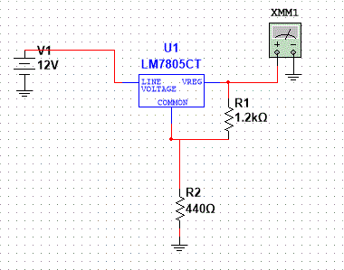

Post schematic .... The 7805 is a fixed reg, how are you setting it for adjustable ?

Sorry Circuit lab wouldn't let me open up the circuit to take a screenshot. I downloaded ltsppice to find it doesn't have a model for the 7805. I borrowed multisim off the world wide web.

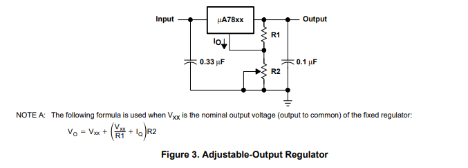

google 7805 variable voltage regulator

I wonder how you made 8V from a a7805 when the error voltage regulation is internal. (3V LED in series with ground pin?). Compare the motor resistance with the driver short circuit current limit or driver ESR which should be less than 5% of motor DCR. Ohms Law applies.
