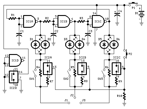

Can anyone tell me if this circuit will or won't work as shown?
I built this without the bilateral switches (so lose IC2, R7-R10). I get no action out of this.
I used a 74LS00 quad NAND instead of a 4011, but that should still work, right?
Any help appreciated.

Wrong.
Why do people build circuits with substitute parts without reading the data sheets and then wonder why they don't work?
The input characteristics of a 74LS00 and the 4011 are quite different, which the data sheets will show you. The 74LS00 is a TTL device which requires 0.4mA to ground for a logic low. That requires a lower impedance than 10kΩ. The 4011 is a CMOS device and requires <1µA for a logic low. 10kΩ is fine for that.
The most likely reason I can think of is that you have the wrong type of transistor. This circuit (I think) is for NPN. You might have a PNP.

Yes--the circuit is supposed to work on both PNP & NPN, as it identifies the polarity as well as the pin functions.
So, @crutschow: Are you saying a 74LS00x will work with a smaller resistance, or should I just get the 4011 and not bother trying to substitute?
I recommend using the specified 4011 parts. You would have to change both the resistor and capacitor values otherwise.
