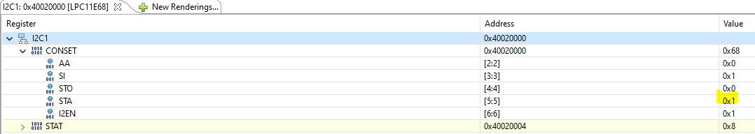

Step 1. I2C1 block is in master transmitter mode because I2C control Register STA bit is set to 1. See attached step1_Master_Transmitter_Mode.png file.

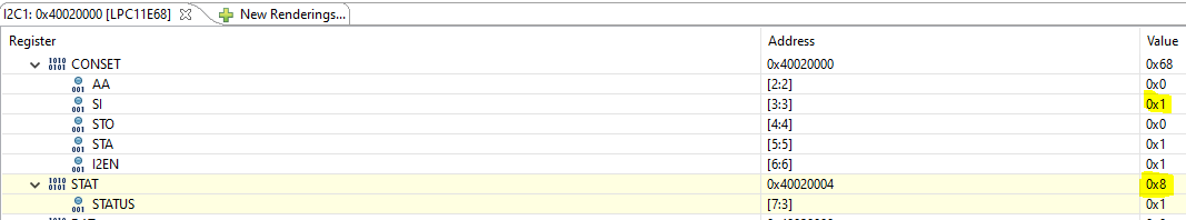

Step 2. Microcontroller I2C1 block transmits START bit. After the START bit is transmitted, the Serial Interrupt(SI) bit in I2C Control Register is set and
and STAT register in microcontroller I2C1 block contains status of 0x08. See attached filename step2_start_bit_sent.png

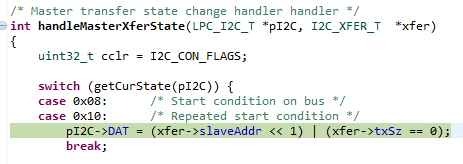

step 3. The status 0x08 is used to vector to a state service routine. This routine loads the slave address and Write bit to the DAT register.

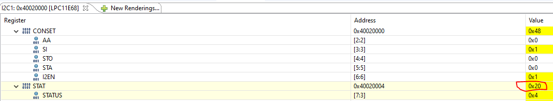

step 4. Slave address and Write bit has been transmitted and negative acknowledgement(NAK) is received from slave. The STAT register has status of 0x20 and
microcontroller fires interrupt on this status value. See attached step4a_NAK_from_slave.png file and step4b_NAK_handler.png

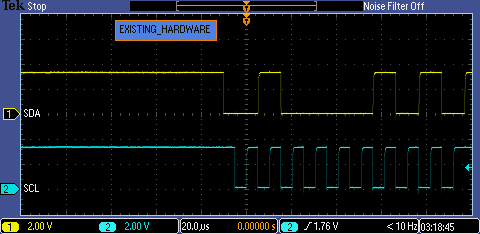

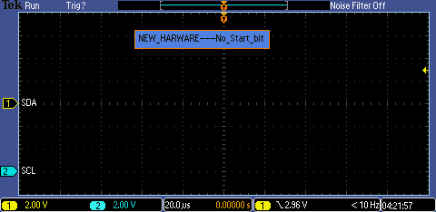

Attached are scope screenshots for existing hardware and new hardware.
With existing hardware, slave sends an ACK.
With new hardware, after START condition is transmitted, master fires an interrupt to inform software that START bit has been transmitted but I don't see it on SDA line. I'm triggering on START bit. What might be the problem?
Some inputs in the I2C expander chip are floating. Is this preventing the START bit to appear on the SDA line?
From I2C expander datasheet: "External resistors are required for inputs (on P Port) that may float. Also, internal pull-up or pull-down may be used to eliminate the need for external components."

Looking at the master waveforms, it appears the address is wrong, which would result in no response from the expander.
There is a 0 start bit, then 1 0 0 0 0 1 0 1
That's 0x85 instead of 0x42
Somewhere it appears something is doing a left-shift on the address byte before it is transmitted.
That may be some routine expecting a 7 bit address unshifted address, then shifting it to allow for a separate read/write bit?
Try using 0x21 for the address, assuming that the hardware address pin is high?
Problem Solved:
New board #1: saw NAK in software ISR
New board #2: SCL and SDA not wiggling at all
New boards #3 and #4: I2C Communication appears to be working as expected
