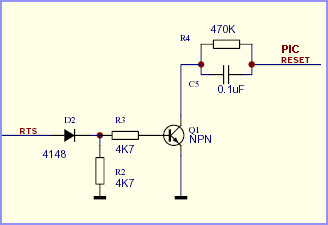

Mike said:
.... moving a jumper on the target board, pressing reset, sending the hex file to the target, moving the jumper back, and pressing reset again.
I'm too lazy to go through all that and came up with an automatic PIC reset circuit.
After I done compiling, I just press the "Write Flash" button in and the PC Bootloader front end then resets the PIC into its bootloader and downloads the new hex file. One second later after hex download completed, the PIC internal bootloader passes control to the new code.
I use Mecanique Bootloader, and yeah, i agree, the automatic Reset is handy.

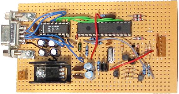

Here I have attached an ICD circuit one has already made.
Now if I want to program a new PIC16F876 where do I have to insert the chip? In the circuit already there is a 876 PIC.
I can plug the RS232 cable into this circuit. After that can I program with IC Prog?
You have to connect it outside the ICD. There's a small socket with five pins. Run a cable from this socket to the right pins on the PIC you want to program. Look at the datasheet for the PIC to see wich pins. They're named PGD, PGC, MCLR. In addition you connect Vdd and Vss (+5V and GND)

The only program you can use with your ICD is MPLAB from Microchp. You can download it for free from the Microchip Website.
Your ICD uses an ICSP connector. It has the MCLR, PGD, PGC, +5 and GND pins. Take a look at the schematics you built it from. It is up to you to get these signals to your target chip. Most often we put an ICSP connector on the target board and use a cable to connect the ICD ICSP to the target ICSP. This saves having to move the chip to and from a programmer socket.
EDIT:
Did you build this ICD? If so I am not sure that you understand it. The ICD has a PIC on it that is used to program other PICs. The problem is that the onboard PIC needs to be programmed or the ICD will not work. So if this is your only programmer you have no way to programm the onboard PIC.
That is to say: The PIC on the ICD is part of the ICD and not a target for your use. It is the brains for the ICD.
Did you use a new/blank PIC in the ICD or has it been programmed for use with the ICD?
