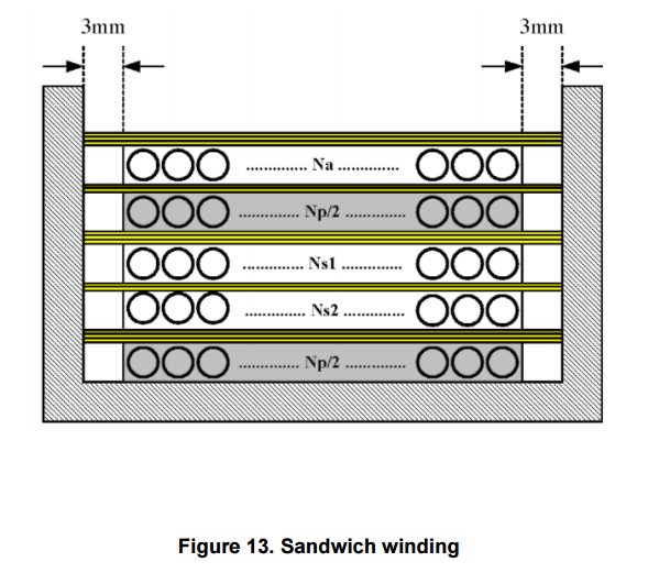

We have one layer of secondary (13 turns) , which is "sandwiched" between the two primary halves, which are in series (26 primary turns altogether).
Therefore we instructed them to wind the first primary layer, then wind the second primary layer temporarily on a manderel. Then wind the secondary, then wind the other half of the primary (which had been on the manderel) on top of the secondary.

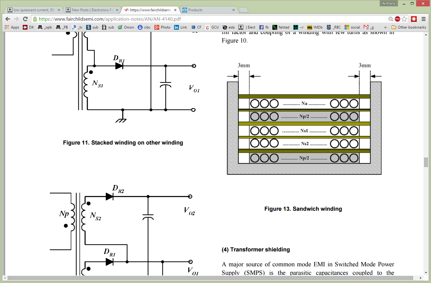

Is this what you are doing?
https://www.fairchildsemi.com/application-notes/AN/AN-4140.pdf

Have you considered putting a layer of kapton tape between primary and secondary. If you did that it wouldn't matter (as much) if the enamel was scratched as it wouldn't short primary and secondary. although you could still get some partial discharge or localized heating which would all depend on the frequency used.
