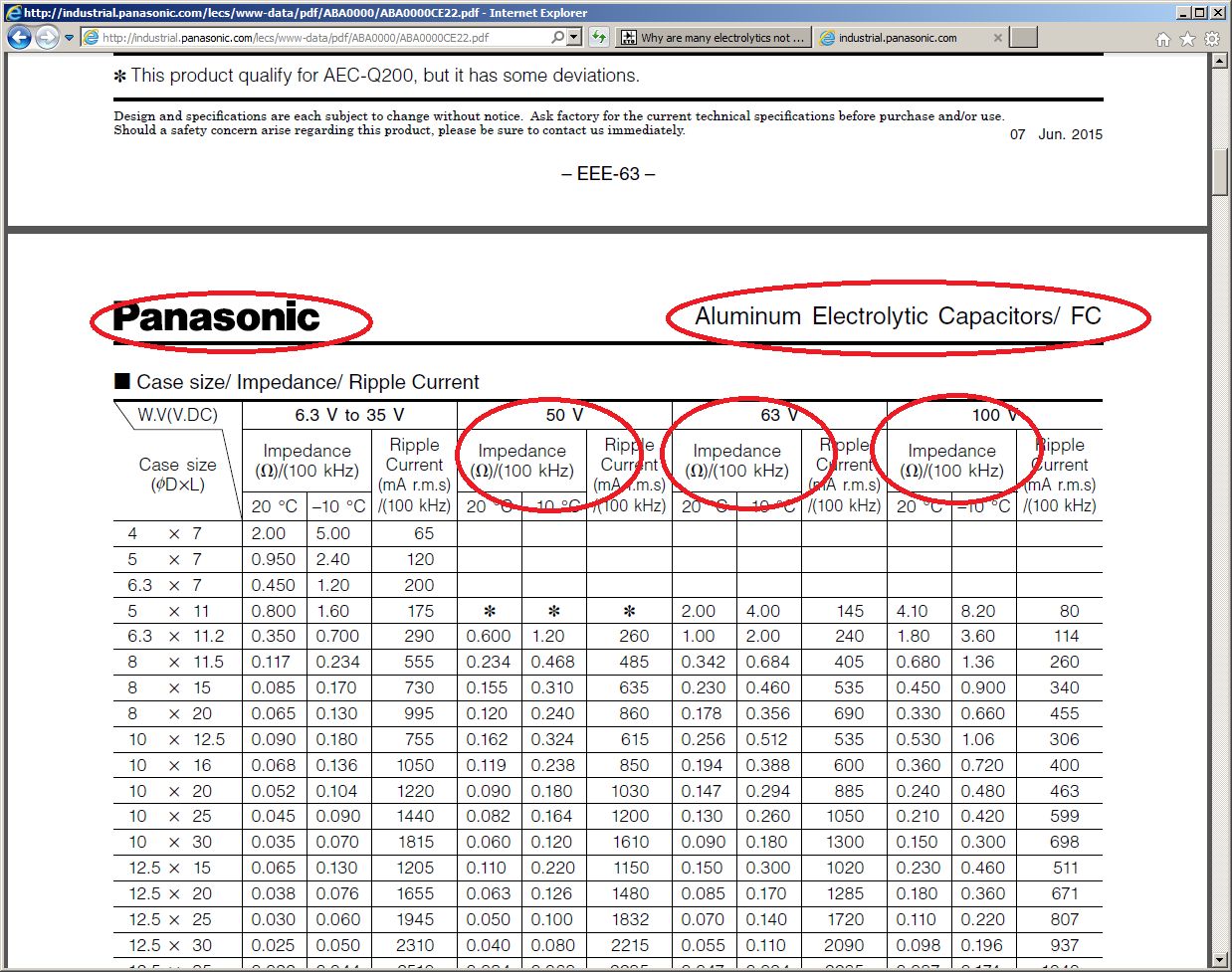

Take Panasonic FC series capacitors, widely available and inexpensive. Or Rubycon ZL series, so Pana doesn't feel lonely. Neither of them are specifying ESR for these in their datasheets. Why is this?
Me :)
Look what I just found:

Yes it is, that's just how that particular datasheet expresses it - as to which method might be 'right' or 'wrong', I would say it simply depends on how you look at it :D
For example ESR - specifies 'resistance' actually in the name - but as this is an AC measurement (normally at 100KHz) shouldn't it more correctly be called 'impedance'?.
So don't overcomplicate things for yourself :D

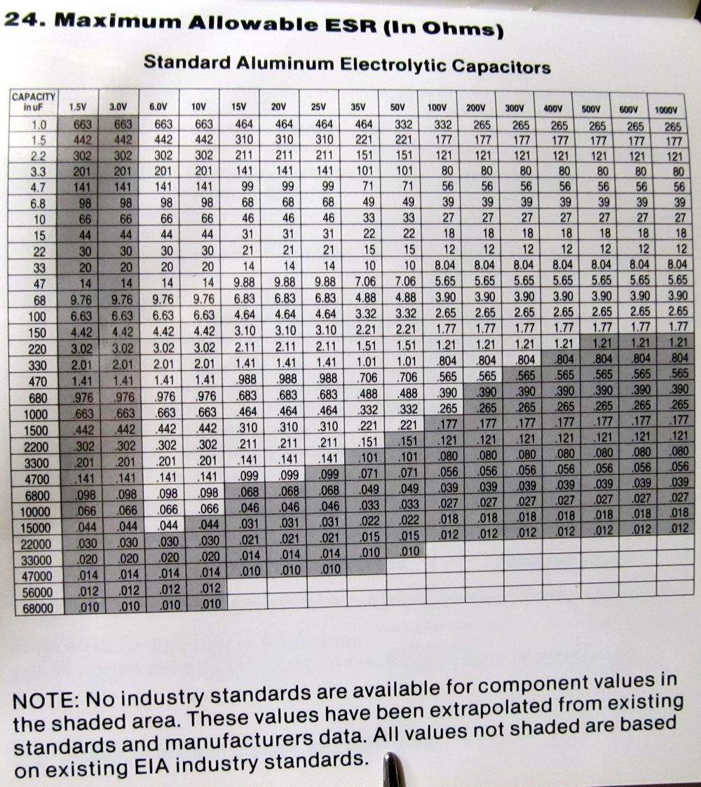

According to my Secore Capacitor/Inductor Analyzer, they have This Documentation.
But I Find the Smaller SIZE Capacitors are Usually HIGHER ESR and Worse than these Recommended Values.
So that Chart in Post #2 Makes sense.
