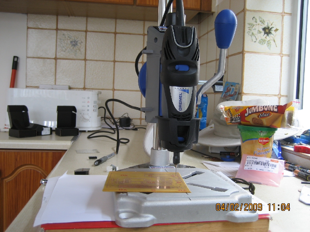

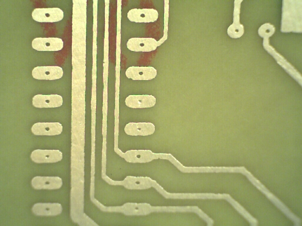

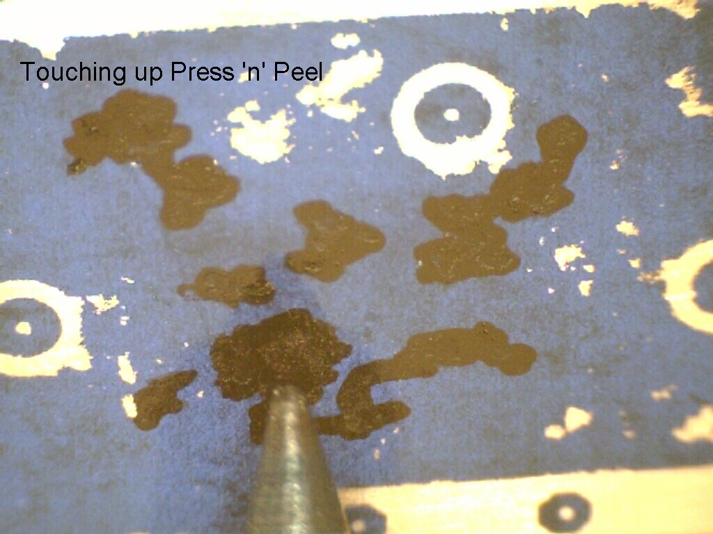

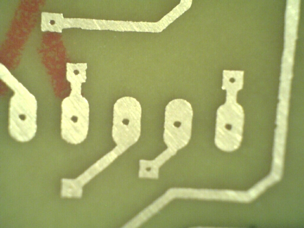

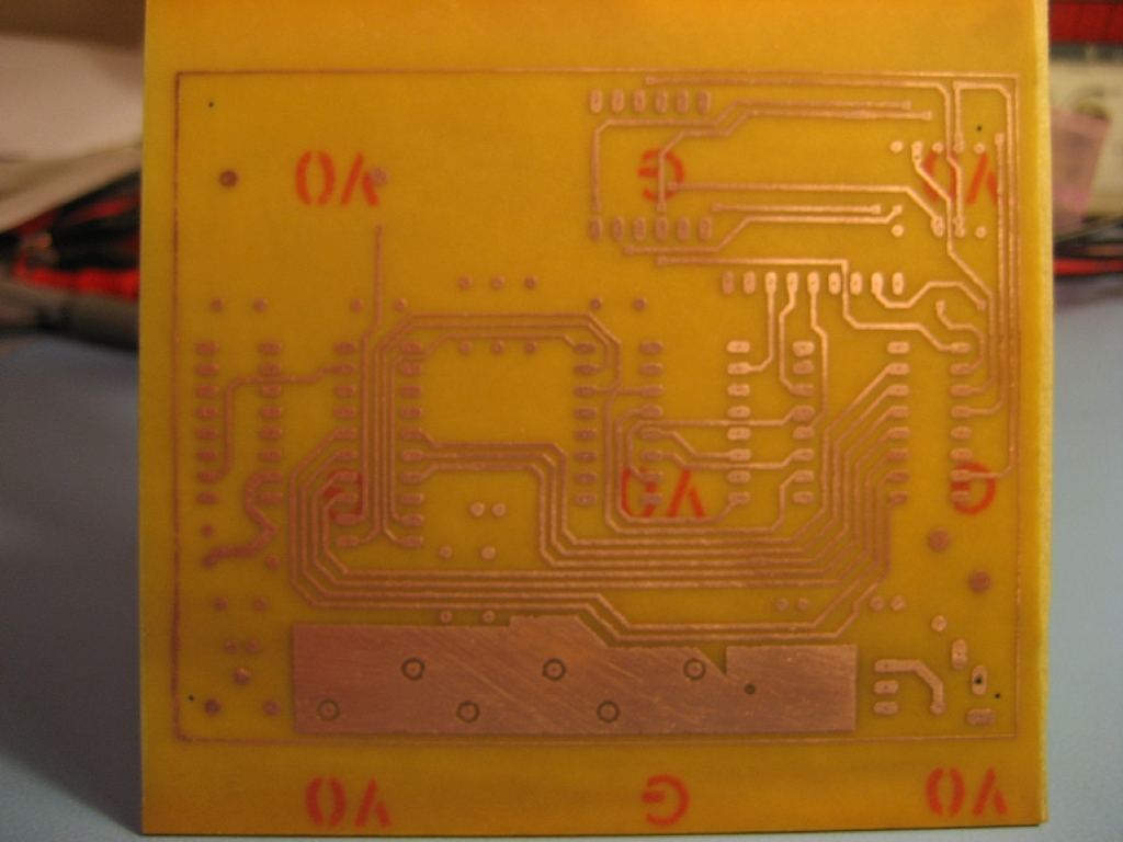

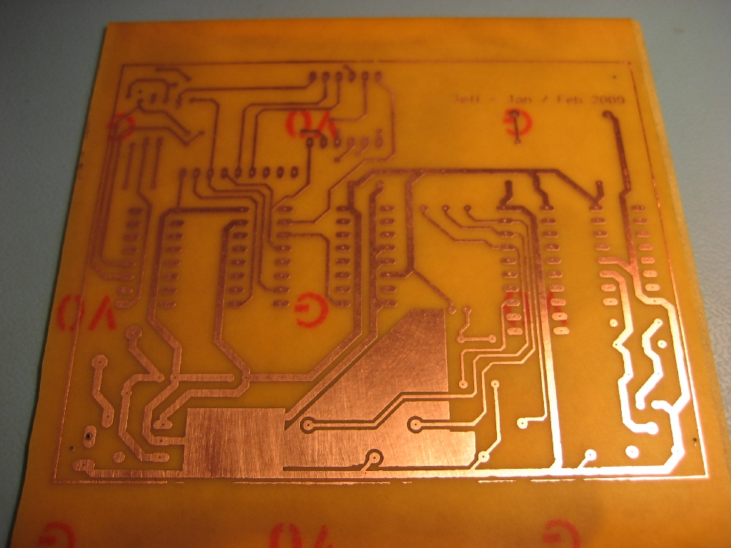

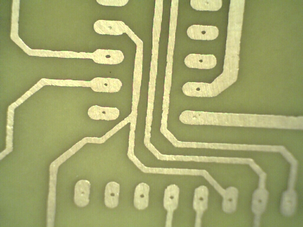

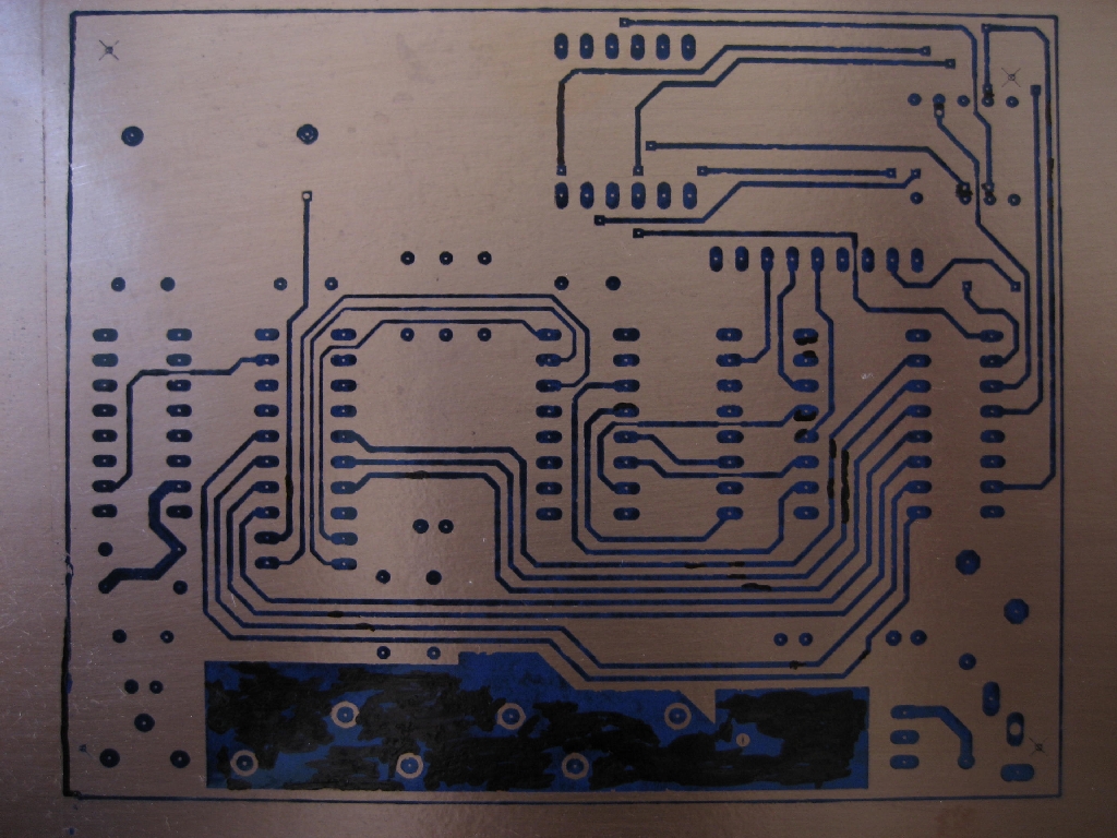

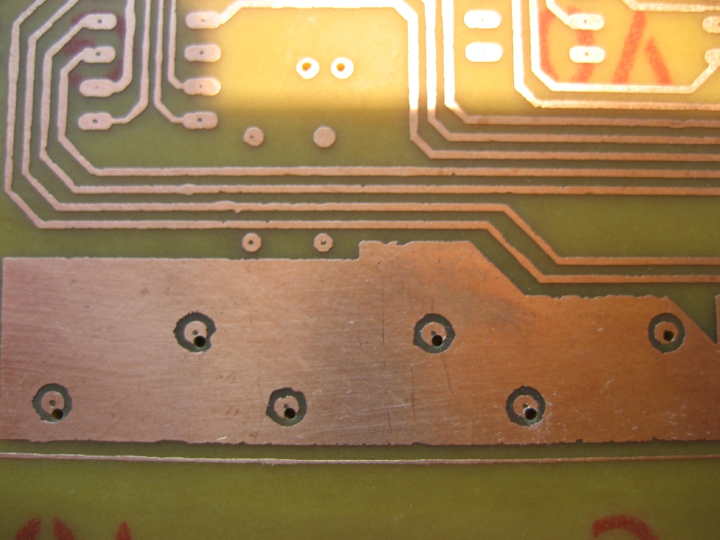

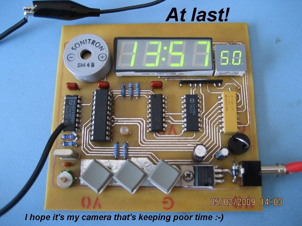

Gave up on the laminator idea - for now anyway. Took several attempts to get a decent print with a clothes iron, had to keep the iron on the board for 20mins-ish and had to do some touching up with a pen.
Made some mistakes - ended up with my switches the wrong way around. Poor alignment between the top and bottom layers but I just about managed to 'get away with it'.
Anyway this is the result:
Thanks to everyone who provided assistance with my project, directly or indirectly.

Heres a tip
Print the artwork out on paper first with 3 sacrificial pads/holes in 3 corners of the PCB. Drill these before doing the rest of the developing/ironing/transfer and its easier to get both sides lined up.
Apart from that - its looking good :) I use photoresist and get fantastic results but a lot of people seem to like this press and peel stuff.
