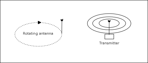

I currently met a problem, I need to use a microcontroller to find the direction of the target in a small range ( <=20 meters ), laser and ultrasound do not work, think of the following methods
1. Make the target as a signal source, and the two antennas of the receiver judge the Angle according to the difference of the signal arrival time.
2. Only one antenna on receiver, and the receiver rotates to find the strongest Angle of the signal.
3. Same as 2, but add a 'shielding surface' to find the two places where the signal disappears to judge the target location
Which plan is easier to achieve?

At around 400 MHz, a small pseudo "Doppler direction finder" is very practical.
There are numerous designs around, using two or four antennas.
The principal is that you use simple logic or an MCU plus diode switches to cycle through the antennas at audio frequency, a few hundred hertz.
The changing distance between "the antenna" (in use at each instant) and the target gives an audio tone through an FM receiver. The phase of that audio tone gives the direction to the transmitter.
