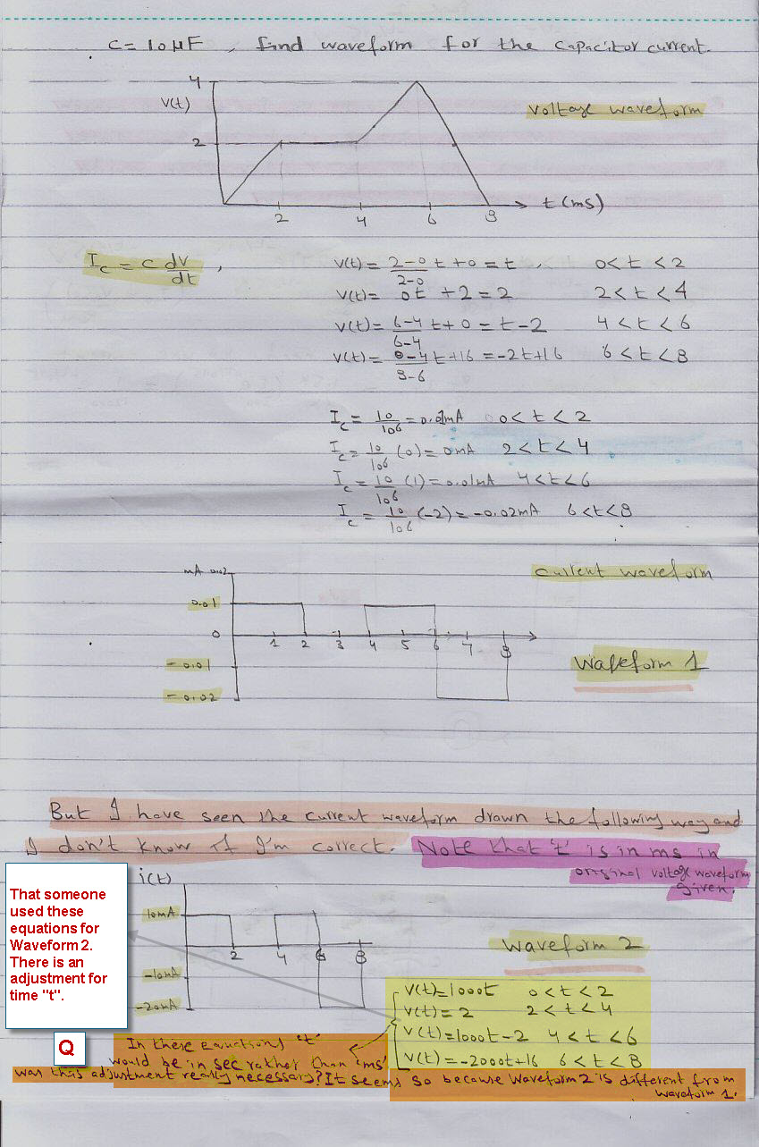

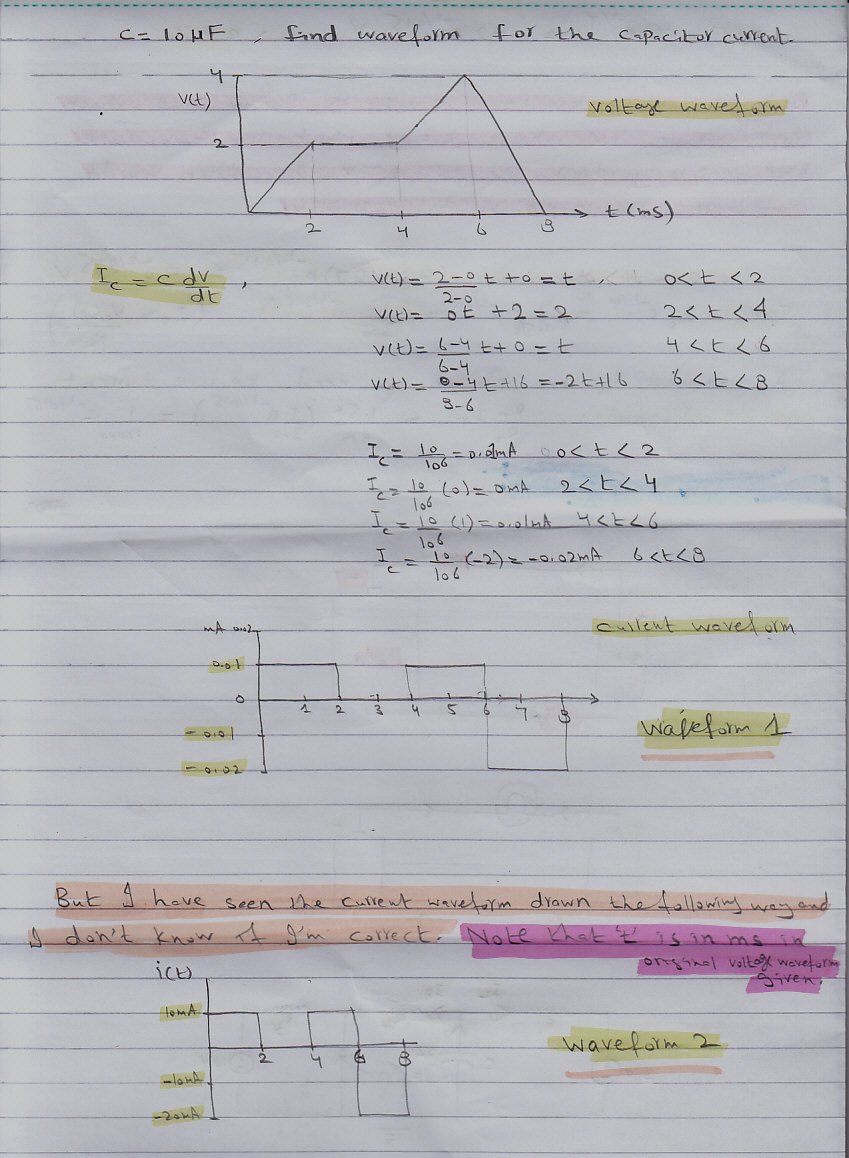

which capacitor current waveform is correct?
PG1995
Active Member
Hi
Please have a look on the attachment. Please tell me which current waveform of the two, Waveform 1 or Waveform 2, is correct. Thank you for the help.
Regards
PG

It seems I'm still little confused about the waveform. So, please help me. Please have a look on the attachment. It has my question "Q" at the very bottom.
Regards
PG
Is that input waveform just a few ramps and horizontal lines?
It's kind of hard to read your writing. If it was typed it would be much easier to help.
