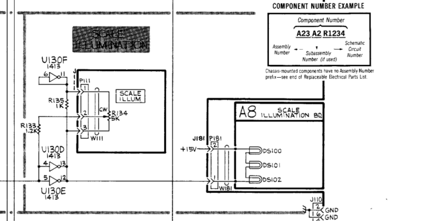

Where would the "bright-up" circuit be on a 2445A schematic?

I assume it's a circuit that increases the trace brightness in response to high sweep speed settings. If that's what he called it then I would look for that or similar wording. It likely has connections to the high sweep speed settings on the sweep speed switch.
"Bright-up" ? That is not a standard term... Is it about the graticule illumination or the trace brilliance ?
The circuit for the graticule/scale illumination is on page "diamond4" or page 225, U130, attached.
The trace intensity is on page 229 of the .pdf

The trace brightness control on my old analogue scope is labelled 'Intensity'.
Crutshow might have been close to the mark.
On page 275 of the manual (2645A) the block diagram shows part of block 5 as a 'display sequencer'. Two of the outputs are 'sweep rates' and 'delay select', and these outputs find their way into the Z axis amplifier which is also part of block 5. The function of the Z axis amplifier is to affect/control/monitor the display trace brightness. My guess is that, if what your guy said is along the lines of what crutschy reckons, then your trace brightening will found in this part of the box.
U650 has 2 outputs HSA1 and HSA2. these are found on page 306 at 7F, and come from page 297 point 2G. These logic functions go to U950 and then become VZout at 8M on page 306. then on page 231 at 6A, you find VZout. This line goes to the control grid/grid no1/intensity grid of the CRT. This starts to get mixed up with the DC restorer and there is voltage multiplier shown, and there is a 22 megohm resistor attached to the grid. The voltage here is possibly up to say 100 -200 volt and the high value resistor is probably what your friend was referring to. There may be other high voltage resistors around the CRT circuit which cause trouble too. These High voltage resistors can be troublesome. They are generally long in length and the carbon track is very resistive, and all this conspires to give unreliable resistors. Resistors have a voltage rating when you get high voltages across resistors and this point is not often appreciated. Sometimes a designer will use two normal resistor in series to improve the voltage rating.
