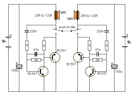

Where is the Mic in This Circuit ?!
aljamri
The speaker is used as a mike. dual function.
The speaker works in 2 modes. It works as a microphone when the push-to-talk switch is pressed (at your end), and as a speaker at the far end.
No extra microphone required.
It is interesting that power comes from the far end, through the speaker. Quite a clever circuit.

OOOPS .... thanks for your swift answers.
Is this a special type of speaker/Mic ? or a separate speaker and a Mic to be connected in parallel ?!

Its only a speaker, most speakers will work as a 'crude' microphone.
Note the impedance of the speaker
Ohh my God, Is that true. Can I use my 8 Ohms speaker as a mic ???
That circuit specifies a 25R to 125R speaker..
But your 8R would work on a suitable amplifier, try connecting the speaker leads to a scope and talk into it..

A speaker used as a mic makes a very boomy sound due to its resonance.
Gas stations have a very cheap intercom at the pumps that use a 45 ohm speaker.
Google and most of the world never heard of a 25R speaker. They know about a 25 ohm speaker instead.
