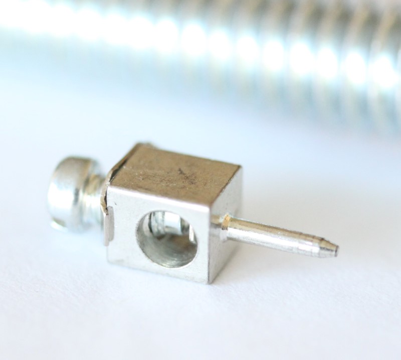

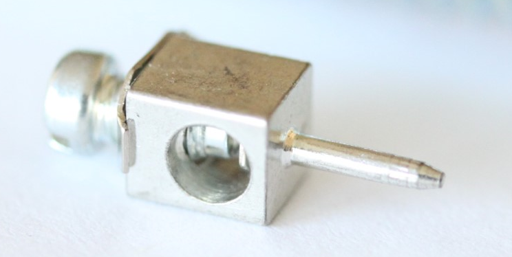

This is the post I need to have at each end of the fuse holder.

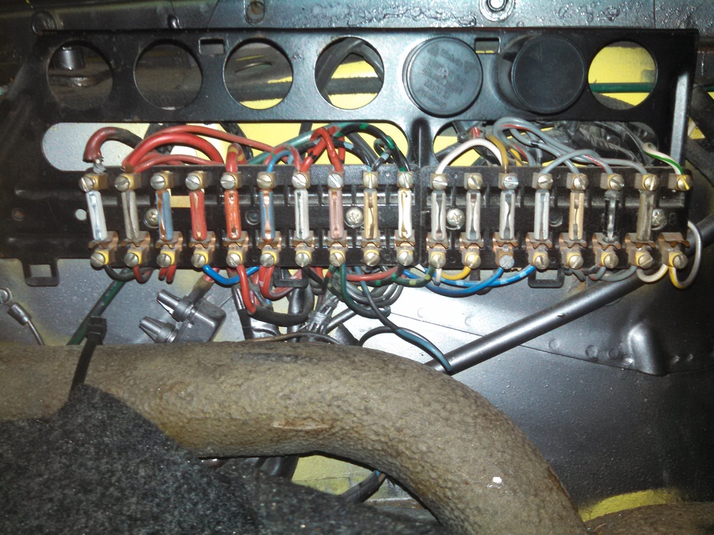

This is the old ceramic fuses I'm trying to replace.

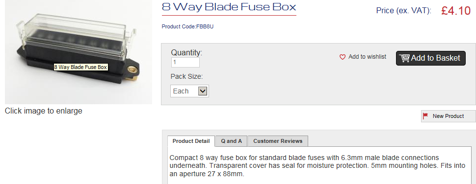

But, the first thing that jumped out at me was the screw terminal:
When that is soldered in to a PCB and you tighten up the screw, the solder joint on the pin end will very likely break, or at best be weakened and eventually break due to vibration in the vehicle.
My next thought was that the whole thing would be rather exposed to the environment and look like a poorly engineered solution.
So a quick googling found this:
A fully engineered solution for not much money.
(OK I know this is half a world away in the UK, but I am sure that similar things are available in Ozz.)
Reading the details, the wire connections to this fuse box are done with blade connectors, so you will have to crimp the appropriate connectors onto the existing wiring.
I think this may be a neater better engineered option that making a PCB etc etc.

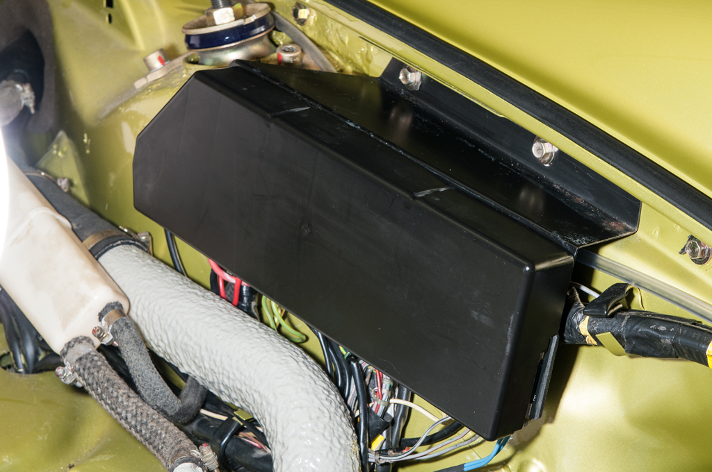

First off the existing fuse box does have a cover for it so any new fuse system will need to fit under it.
Secondly the car is an old classic so I'm reluctant to cut the existing crimped ends off any of the wires.

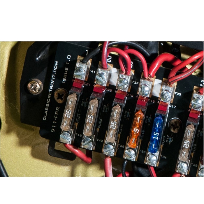

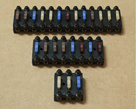

There are two commercially available alternatives but their cost is prohibitive to say the least. Both around $520 AU less shipping.
I know one choice has a blown fuse LED but I don't need that.
You can see why I'm keen to make my own.

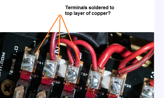

OK, all understood.
There is a "Plan B" which I had in mind but didn't mention it because I thought the idea of bought in solution may be more attractive.
If the PCB for the fuse holders and terminals is made from double sided board, you can have copper pads on the top of the board and solder the body of the screw terminal to those pads.
Looking at the commercial example which you have shown, it looks as though the people who made that unit did exactly that.
If my interpretation of the picture is correct, there are copper pads under the terminals and some of them appear to be soldered.
What do you think?
The terminal post in your picture is exactly what is in the normal tblocks I use
https://uk.rs-online.com/web/p/pcb-terminal-blocks/4948956/
when you remove the metal from the plastic it looks like the one in your picture .
What do you think?
Awesome Jim,
I would never have thought of that. That seems to be the solution.
Now all I need is a supplier??
Frank

Look back at post #5, there is a cover.
