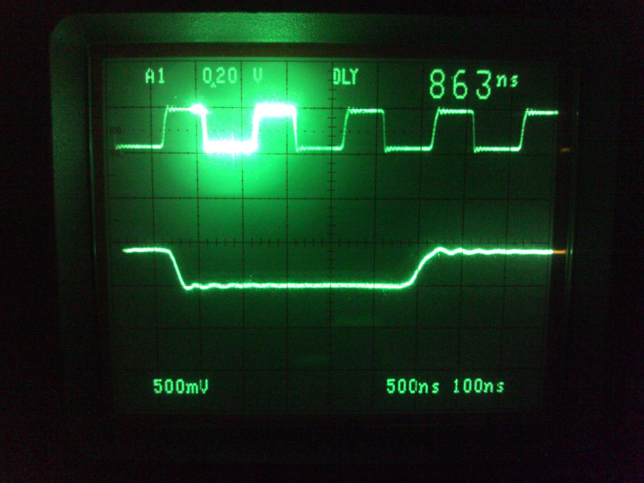

I've just got an "Orange San Diego" Intel Android phone, and have been practicing trace shots:
try placeing a little bit of tracing paper in front of the flash bit ;), if using a flash unit that has a swivel head, then aim the flash up and bounce it
well mostly you wouldn't with a tripod, but sometimes you get no choice. slow shutter speed/no tripod a phone camera that wont let you turn off the flash. then mt advice is good, also in the pic it looks like some kind of flash was used, until I looked closer, and can see its probably the beam and a slow speed on the camera or sweep. When I take scope shots I do normally use the flash tho, even with a tripod, on my scope with dads camera (Nikon D7000 or D3), I get a much crisper image.
So I can see why you say what you did. But try playing with it a little, sometimes bounced flash or diffused flash works well. I only know because I only take pics of electronics or scope for here :D.
If you get better shots without a flash with your camera and scope, stick with that, but others reading this that cant get a good result your way, have another option to try now.
And respect wasnt needed ;) It was a valid question :D

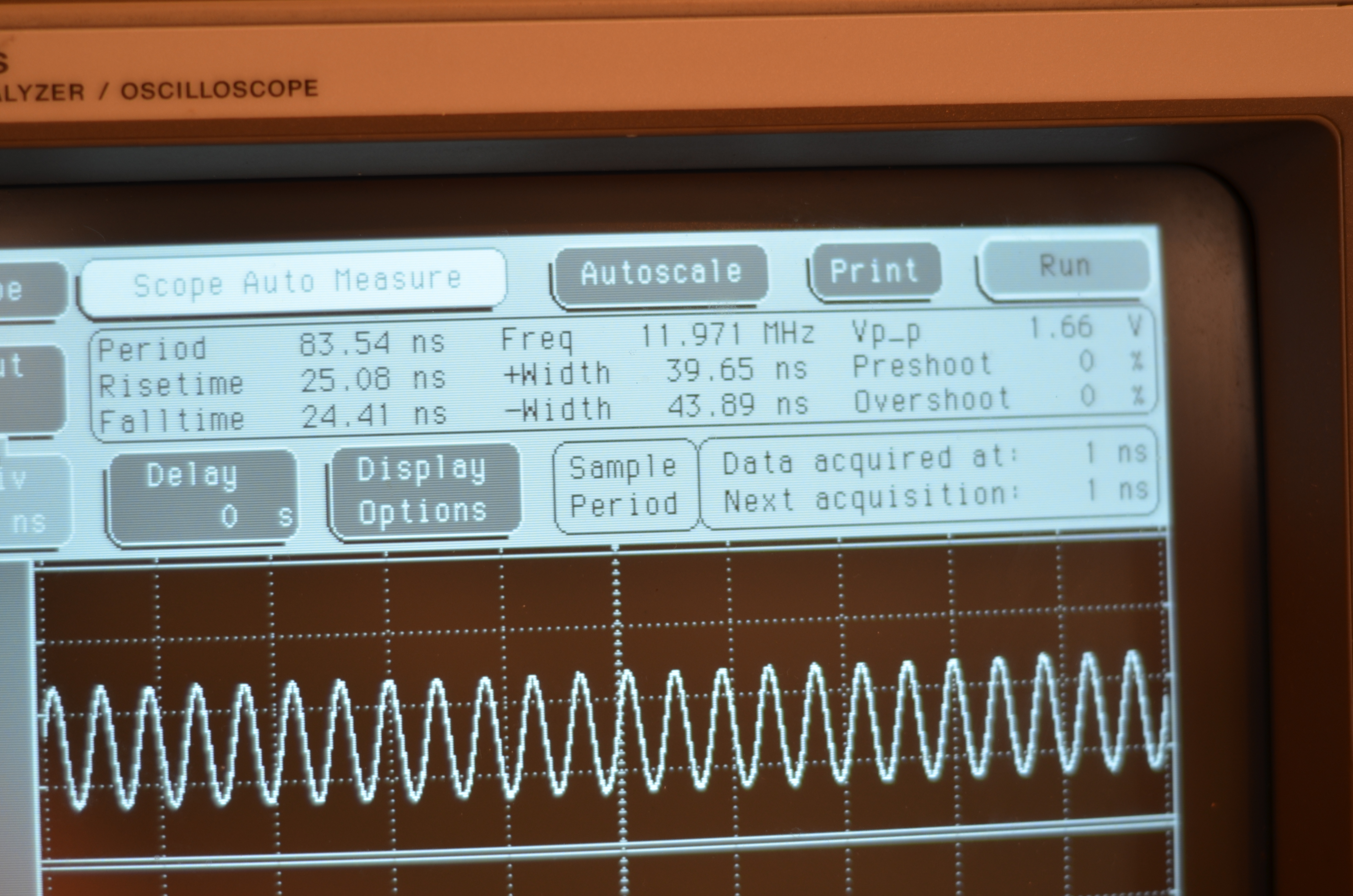

ok a bad example but one I grabbed quickly
https://www.electro-tech-online.com/attachments/scope-osc-jpg.81560/
I used wrong lens and hand held, the whole thing was did in a rush, and the screen type is different, but look at the frequency and see the small steps in the trace?, I couldn't see those with my eye, they are there because I was able to use a very fast shutter rate, as I used the flash. Me and dad dabble a small amount with photography, mum is really the one I should ask, she is a great photographer!! mainly portrait stuff and wild life, but she has won loads of comp's

well to be fair, it was mentioned about seeing dial settings etc, and the pic that was posted of the crt trace is very dark! A tripod isnt so essential with a very fast shutter.
