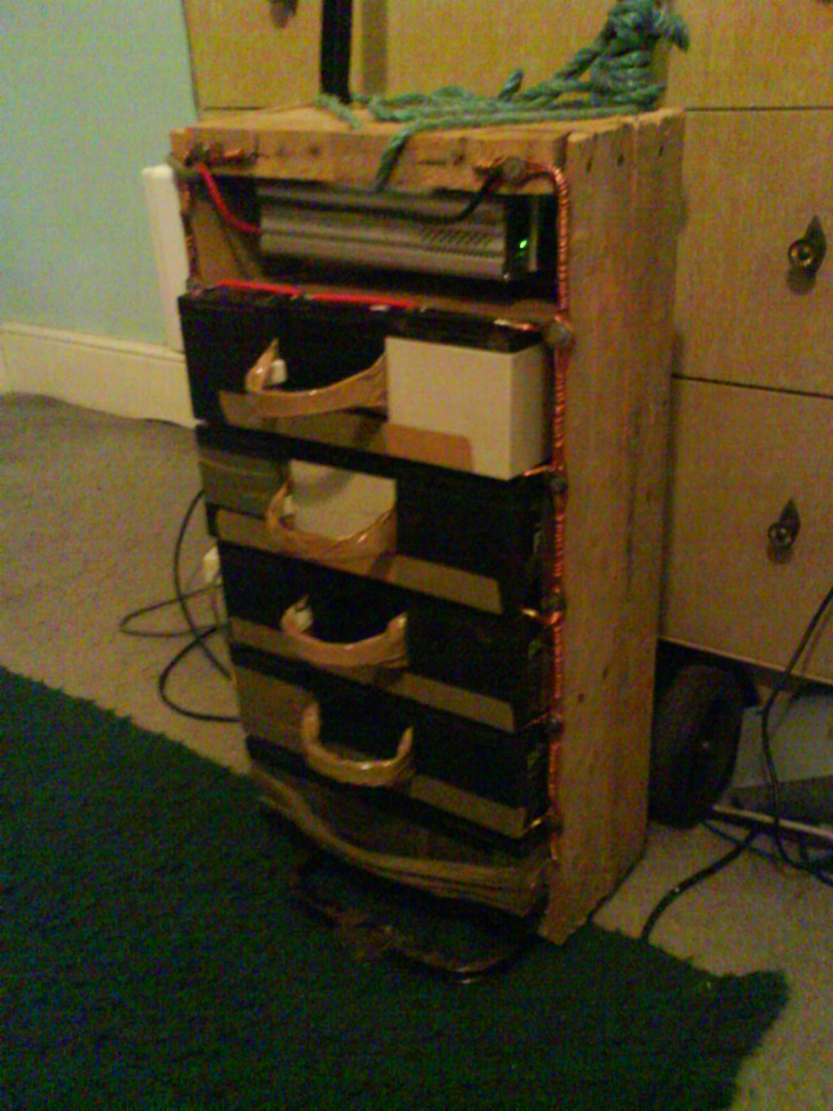

Not to mention the relative absurdity of putting that many lead acid cells in parallel... The pulse current that would put out if you dead shorted the power leads on accident would be incredible. WAY past explosive vaporization of metal.

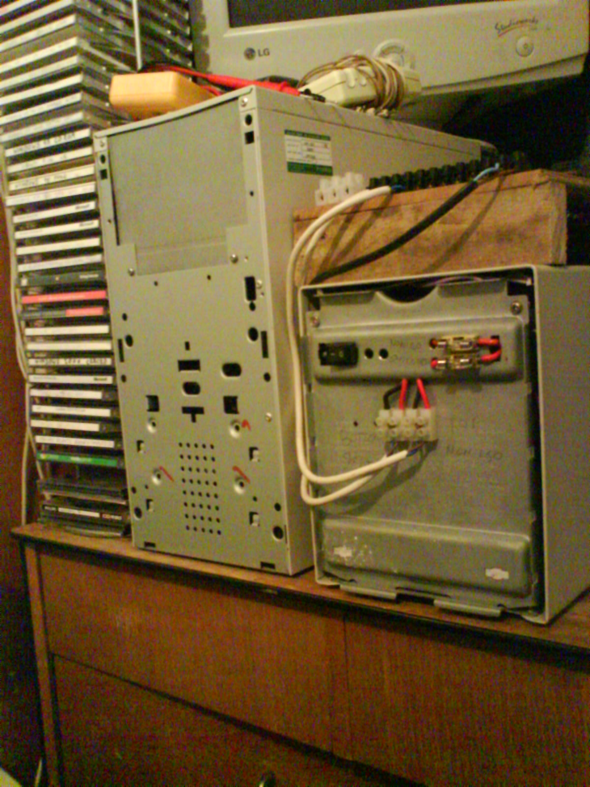

Sceadwian, I haven't done THAT yet... I've put a single strand of copper cable (1mm dia?) for a fuse on the largest pack and 20A fuses on the others. Here's the pics of the setup. The positive and negative sides of the big pack are the bare copper screwed on the left and right of the batteries. and the inverter is above the batteries.

Keep in mind lead acid batteries self discharge pretty badly, and 60 in parallel will have bad voltage imbalance between cells causing even more wasted current, efficiency would go right out the window. A straight grid tie and the meter stops spinning just that much right then.
