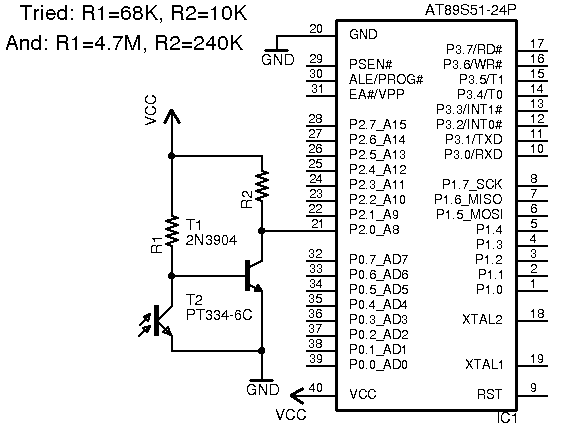

I'm having trouble with this portion of my schematic. The microcontroller that I am using is actually an AT89S52 and everything is done on a PCB all assembled.
What I'm trying to do here is have the phototransistor respond only to red lazer beams (not normal light or infrared). I made two attempts with resistors:
I tried R1=68K, and R2=10K because 10K is a standard pull-up value and 68K because I didn't want detection too picky or too easy. If I made R1 smaller then I probably would detect nothing, but then again, maybe R1 is too small?
So then I tried the new settings of 4.7M for R1 and 240K for R2 so then I can make the ratio larger in hopes that it can detect any kind of light and still nothing is detected.
Now one thing I found out is when I turned my voltmeter on with the new resistor settings and I touched one lead to VCC and the other lead to NPN's collector, the detection takes place.
Before I assume the phototransistor is broken, are there better values for R1 and R2 I can use that would allow the microcontroller to detect when the light changes on the photodiode from super dark to super bright or vice-versa?

I ran tests on the phototransistor in-circuit with the multimeter diode function, and it seems to respond to light. With correct polarity, the measurements that appeared on the meter were roughly 700 in darkness and 200 in bright white light. I'm not sure what the values refer to but at least I can conclude the phototransistor itself still works.

Your schematic does not show your VCC voltage. Why not, it is very important?

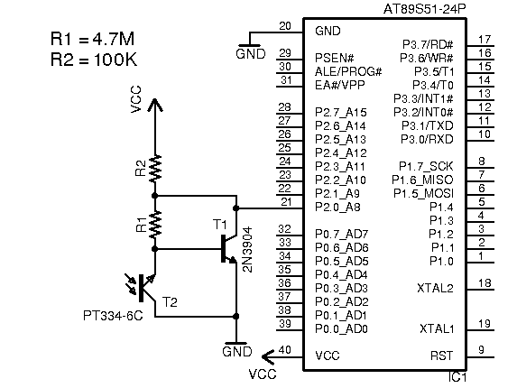

I agree with Colin... but if you want to roll your own (of sorts) with what components you have, then you will need to re-arrange your circuit a bit. The laser MUST be data modulated, but you should be able to get to at least 19.2k Baud with the change below. You won't be able to modulate the data with a carrier at 36-40kHz such as that used for IR with the components you have and without a filter unless you are able to do it in software. As far as not detecting IR and ambient light ... this circuit does pretty good for blocking ambient light, but any modulated IR will need an Optical filter. If you modulate your laser data with unique data packet BYTES (i.e. SYNC,DATA, DATA, CRC), then any IR interference should be ignored anyway without the need for an optical filter.

I see my problem now that I look super close at my board. The collector and emitter pins are connected the wrong way around. I'm blaming Eagle.
OK, I tried Beau's idea and it didn't work. I then replaced 4.7M with 470K and that didn't work. I then made voltage measurements with the meter and when lights detected the output voltage going into the micro is 3.3V and when light is off then the voltage going in is about 4V. this right there is bad because the micro's logic high threshhold is 2.4V. I need to make it where one voltage is below 2.4V. Any other resistor ideas?
You don't need the transistor. The photo transistor already has too much gain, that's why I am reducing the gain. If it is a photo transistor the symbol is around the wrong way

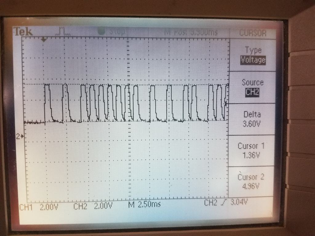

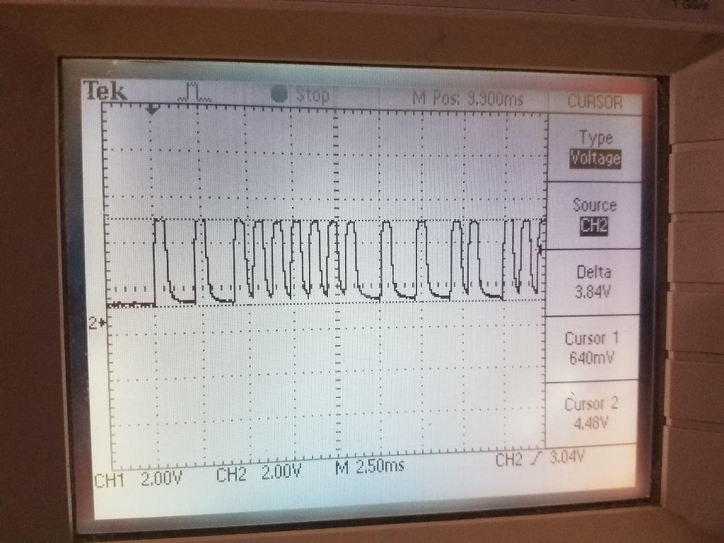

The Photo transistor orientation in post #10 is correct, the Collector goes to ground and the Emitter goes to the Base of the NPN transistor (T1). The Photo transistor is reverse biased on purpose. Below are a couple of scope images from the circuit ... in one image, R2 = 100k in the other image R2 = 470k .... R1 remains the same at 4.7M. I used a TV remote at 4 feet away from the sensor. Using a laser shouldn't be an issue at all but it MUST be modulated (or pulsed) somehow. Just shining it at the sensor won't work in this circuit configuration. If it does, then you have the Photo transistor in the wrong direction. It might work close up, but you'll achieve much greater distance if the photo transistor is properly configured in the circuit.
If it is a photo transistor it must be connected as #1.
All transistors are photo transistors and a transistor will not work properly when connected up-side-down.

I'm going to agree to disagree here and urge you to simply try it for yourself .... A Photo transistor in reverse bias mode acts like a capacitor where the amount of light falling on it will proportionately discharge that capacitor. Without going into too much detail, the transistor acts to self bias the output by quenching the positive supply keeping the transistor operating in it's most sensitive linear region, thus any slight change at the base will swing the output almost rail to rail as seen in the scope images.
