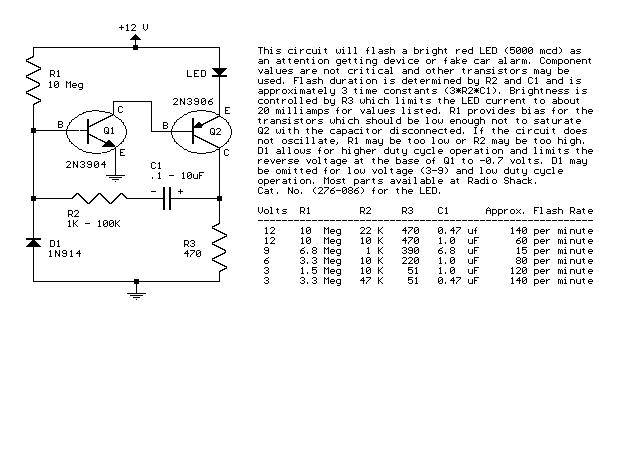

I'm trying to build this LED flasher circuit that I found online. I've got limited electronics experience, but i'm learning more everyday.
Here's the circuit diagram:

The transistor part numbers 2N3904 and 2N3906 are on the schematic and are very common. The author thinks that RadioShack has them.

R3 in the circuit is 470 ohms and is in series with the PNP transistor and the LED. It limits the current in the LED to 21mA which will not blow the LED.
You need to check to make sure the circuit is 'exactly' right. What have you built your circuit on? (strip-board/breadboard etc). Make sure there are no short circuits, no solder blobs joining parts of the circuit which shouldn't be joined (it only takes a tinybit of sodler to cause a short, try looking with a magnifier). Also check the value of R3. the purpose of this resistor is to limit the current to the LED to make sure it doen't get damaged. Based on the info you have given for your LED and the battery (11.4v), R3 needs to be AT LEAST 390 ohms. Make sure you have the transistors the right way round (check the pins) look at a datasheet if you need to.

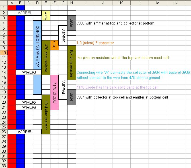

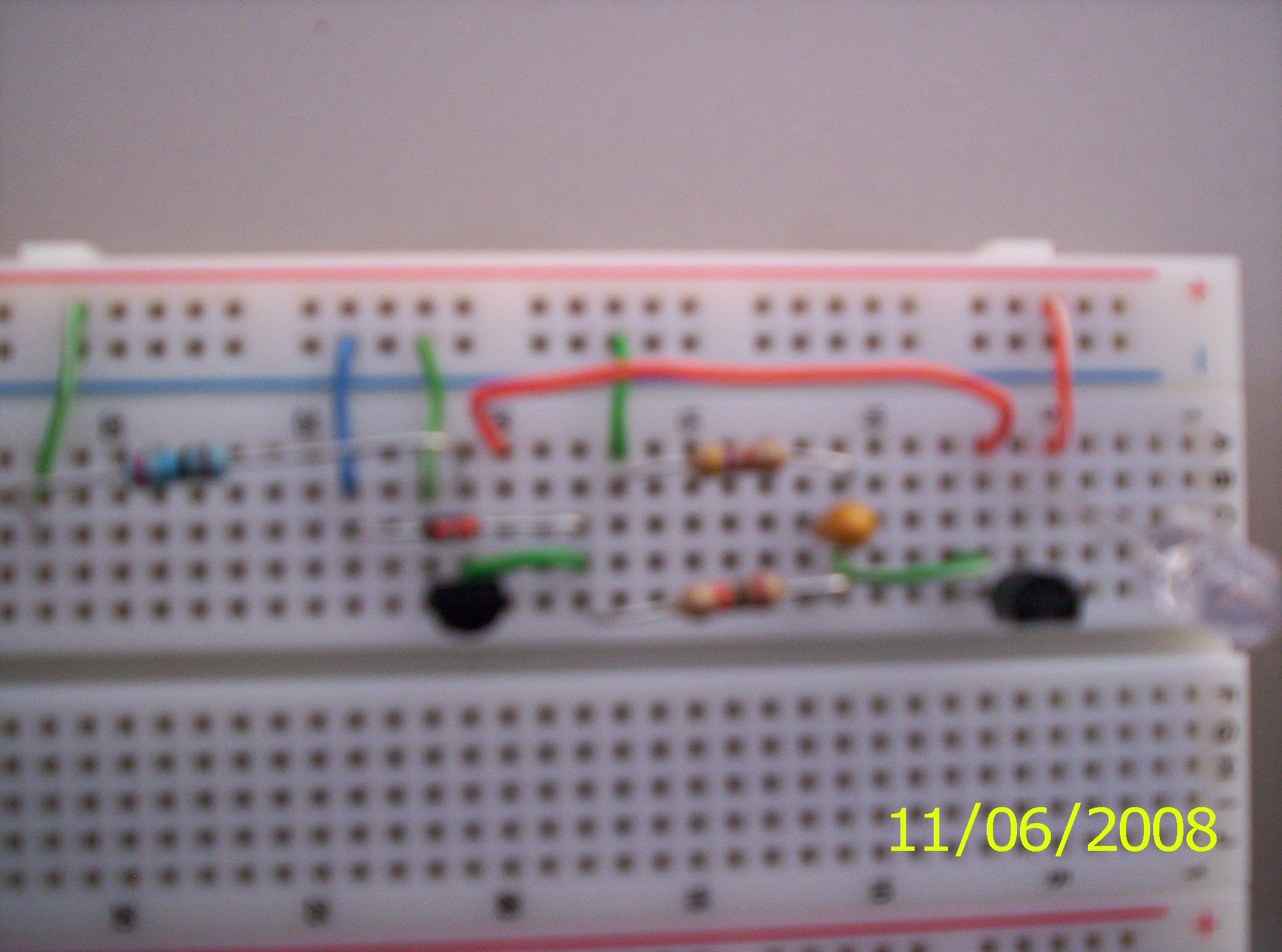

OK, I'm using a breadboard. I tried to take a pic of what I've got, but the pics won't come out well. Either the flash overpowers the pic so you can't see, or (without flash) the pic comes out too fuzzy.
So i made a representation of my breadboard in Excell and took a screenshot of that.
Would you mind taking a look and see if it makes any sense?

Try taking a picture of the circuit in sunlight.
The image still comes out fuzzy, (taken in sunlight) but here it is.

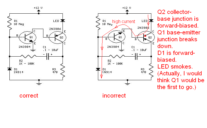

It looks to me like your transistors and your diode are backward. If that's the case, high current will flow through the circuit as shown below.
I have seen this circuit with a resistor (≈470 ohms) between Q1 collector and Q2 base. This will protect you from problems such as this. It will also save you in case you have the wiring correct, but too low a value for R1, which could otherwise cause something to die.

That must of took a bit of work. Clever way to show a schematic. Pain to read but clever.
OK, i can see where i was reading the transistors incorrectly. On the diode, the dark band at one end indicates the negative, correct?
It indicates the cathode. In your circuit, the cathode should be connected to the base of Q1, and the anode to circuit ground.
Neat! it works. Now i just need to figure out how to fit it all on a circuitboard and put it in the model.

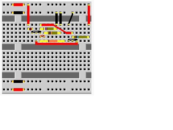

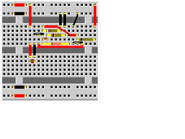

OK guys, i've run into another stumbling block. I can get the flasher circuit to work fine on a breadboard, but not in the actual application. I've got two images here, C1 is the breadboard configuration that works.
C2 is a breadboard configuration in which i try to isolate the LED in an attempt to imitate the LED being at the end of a 24" wire.
When I isolate the LED, it no longer flashes, I just get a solid light. Would anyone be able to explain why this is, and perhaps how i might isolate the LED successfully?

I don't see any reason why moving the led further away would make a difference to the circuit. My guess would be that when you moved the led, you may have distubed one of the other components. try moving the led back to where it was, and check if that solves the problem.
Next, I would try building the circuit 'from scratch', and once you have it working then try moving the led again.
