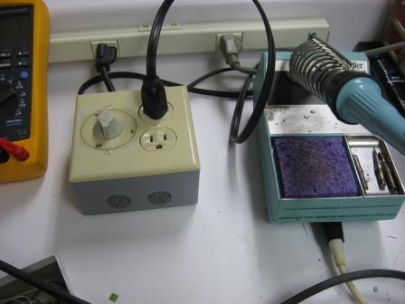

My biggest problem with tip life is forgetting to turn off the soldering iron. I scrounged a wind-up wall timer, found an outlet in my junk, and bought a box. I made the timer in the picture below. I think the timer was originally a 30 minute unit, but when I tried it out, it only ran for 18 minutes, which is plenty long for me. If I forget to turn it off, it goes off automatically.

Cool idea. I notice you have a nice Weller. Those are the good tips I was talking about in my previous post.
