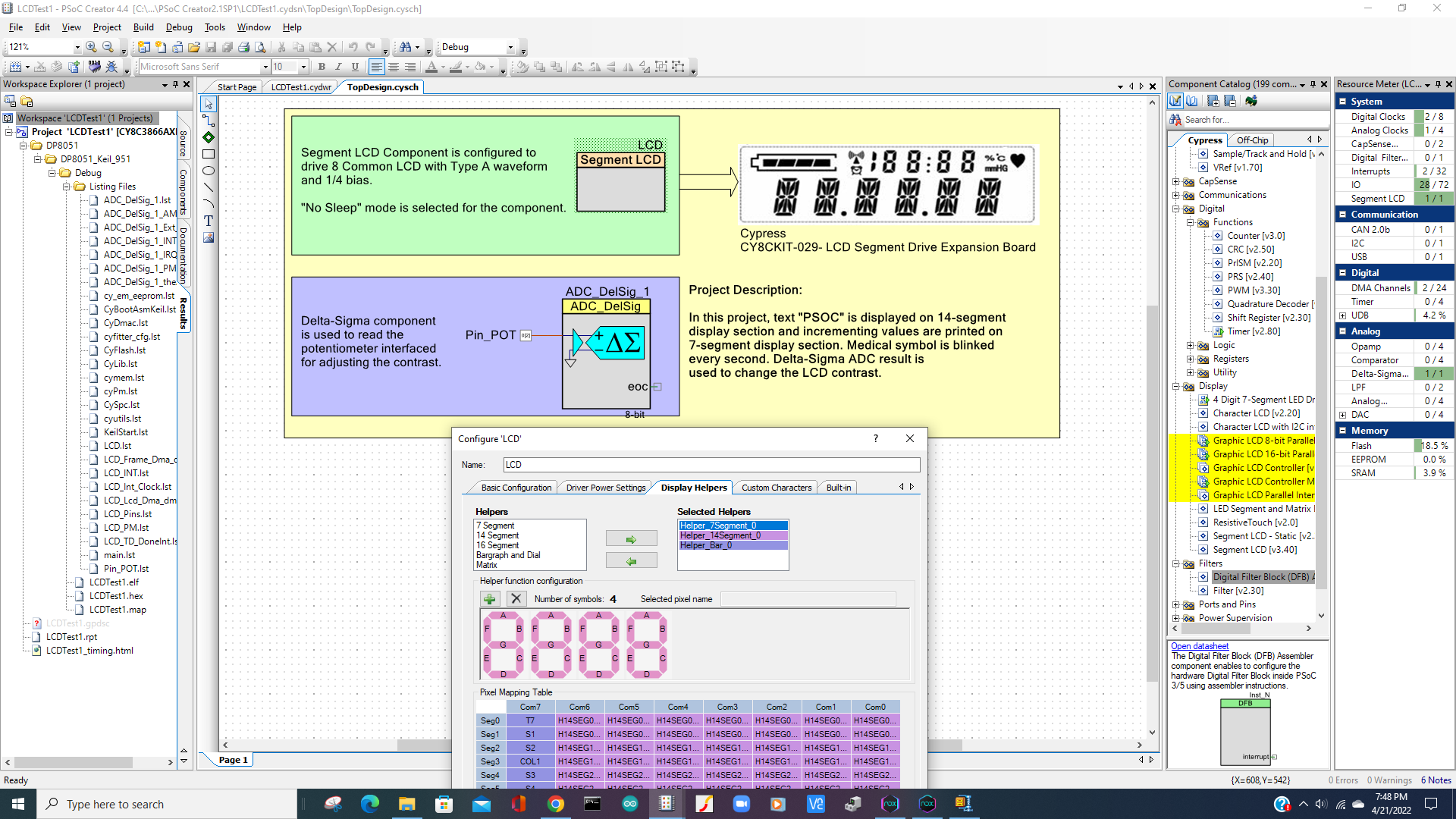

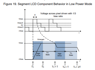

Just an example, some processors have onchip the capability of all the timing and step
V generation required to manage a segment LCD with commons. This is single chip solution,
very little of the overall chip resources used, see last window.
Generating the coms drive -
