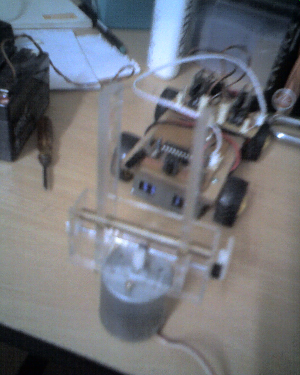

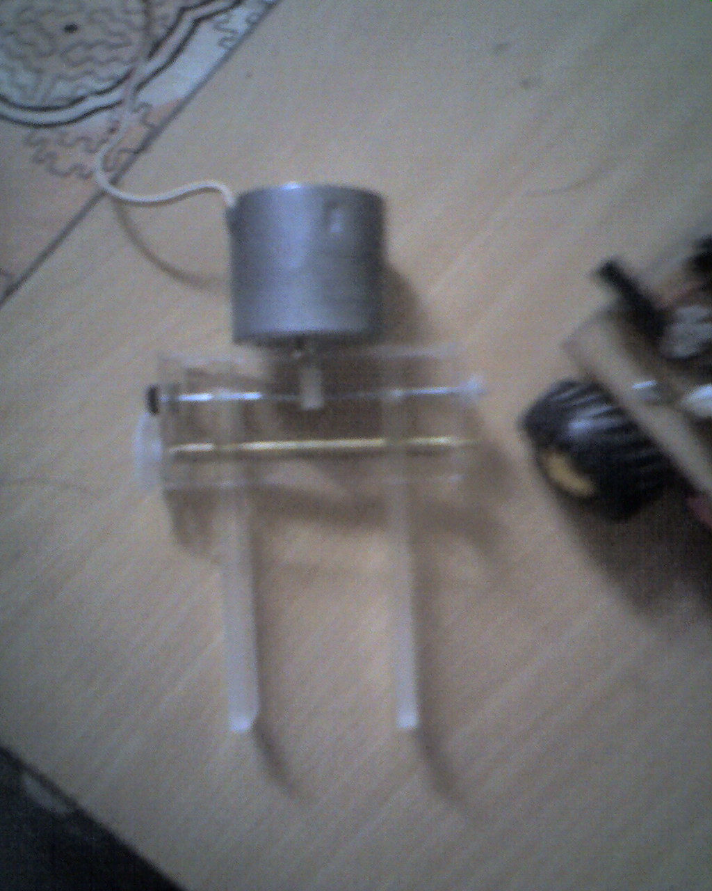

Attached are snaps of what I have built so far. not satisfactory :-(

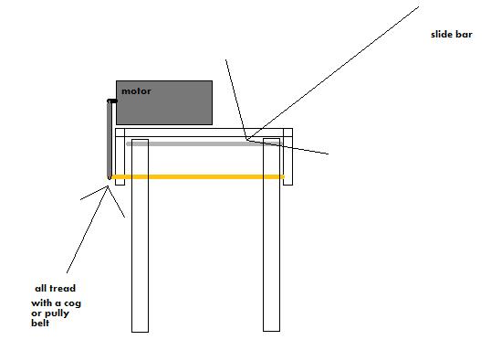

what if you moved the motor around to give it reduce the stress on the motor? having it on it's side could be allot better since the motor has a more direct connection to the threaded bar. you can get all those parts from a floppy drive too!
edit: this will also allow it to completely close
mashersmasher, I agree. that makes a lot of sense. I thought about it but rejected because I am crazy for symmetry :D. I want to somehow keep the motor at the center. that way i could also use it as the joint with an arm tomorrow such that this piece could rotate about it.
Anyway if symmetry IS the price, i guess I would have to pay it finally unless somone helps me with a better idea.
hmm indeed that would be a problem. i posted a link to a grabber a while back that works wonders from my tries and works pretty efficiently on power that would suit your nitpickyness. OR if you wanted to salvage that one and had a couple extra motors you could have one linked to the other side and use both motors to power it.
