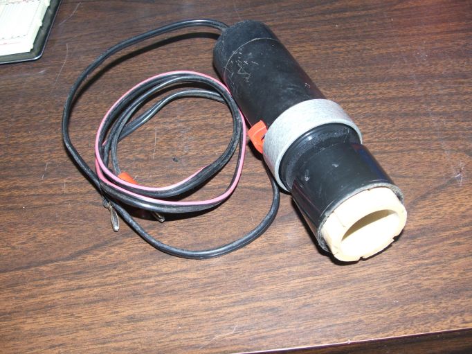

What is this thing? A tool?
Andy1845c
Active Member
I have been meaning to post a picture of this for a while now.
I got it at an auction a few years back in a box of misc. stuff. The auction was heavily electrical tools, so I though sombody on here might know what it is.
It spins when a 9v battery is connected to it and the red switch is pushed down. It has a 25 amp fuse in the back of it. The white end is rubber. It appears it was soft rubber at one time and is harder now with age.
I don't know if its made to spin somthing or made to measure somthing that is spinning:confused: The bananna plugs kinda throw me. I don't know what your supposed to connect it to.

Looks like a handheld starter motor. 12 or 24 volt probably. BananaPlugs are a pretty cheap/generic way of doing quick connects, doesn't surprise me to see something like this at all. Could easily be for an RC car.

I'd guess an RC plane; I think the cars use hand-held glo-plugs.

Real close. I really think it's for starting R/C airplane engines. The starter is held against the propeller's spinner to spin up the gas engine. The ones I've seen for R/C gas cars have a cog gear to spin a belt that stays in the car.
Here is a commercial example:

Wow. Thats exatcly what it is. The link lefty posted looks exactly like it.

It looks like a direct drive, PM, DC motor (12V). Can't tell if it is geared, probably not geared. Starter motors off of small gasoline engines were often used. Duty cycle is low, which may or may not affect its applicability for robots. No-load RPM is high. John
I don't know the RPM, but it is pretty high with a 12v supply.
It has quite a bit of tourqe, but I have no way of measuring it.
Its not super quiet.
It is all motor. It has no battery in it, only the bananna plugs and it does not look like it has gears in it.

In reality, such motors have very little value on the used market. They are about $20 to $30 new at Tower Hobbies.
Since they are PM and brushed, you might want to keep it and use it to experiment with generators.

I had that exact model. It is a cheap one among the others, you may not get too much for it on ebay if it is used. Those motors have quite a bit of torque, not too loud cause there are no gears.
Just be wary if you use them for a robotics project, they're starter motors so they're not meant for contious use, you may have heating trouble if you try to use them as a constant duty motor.
