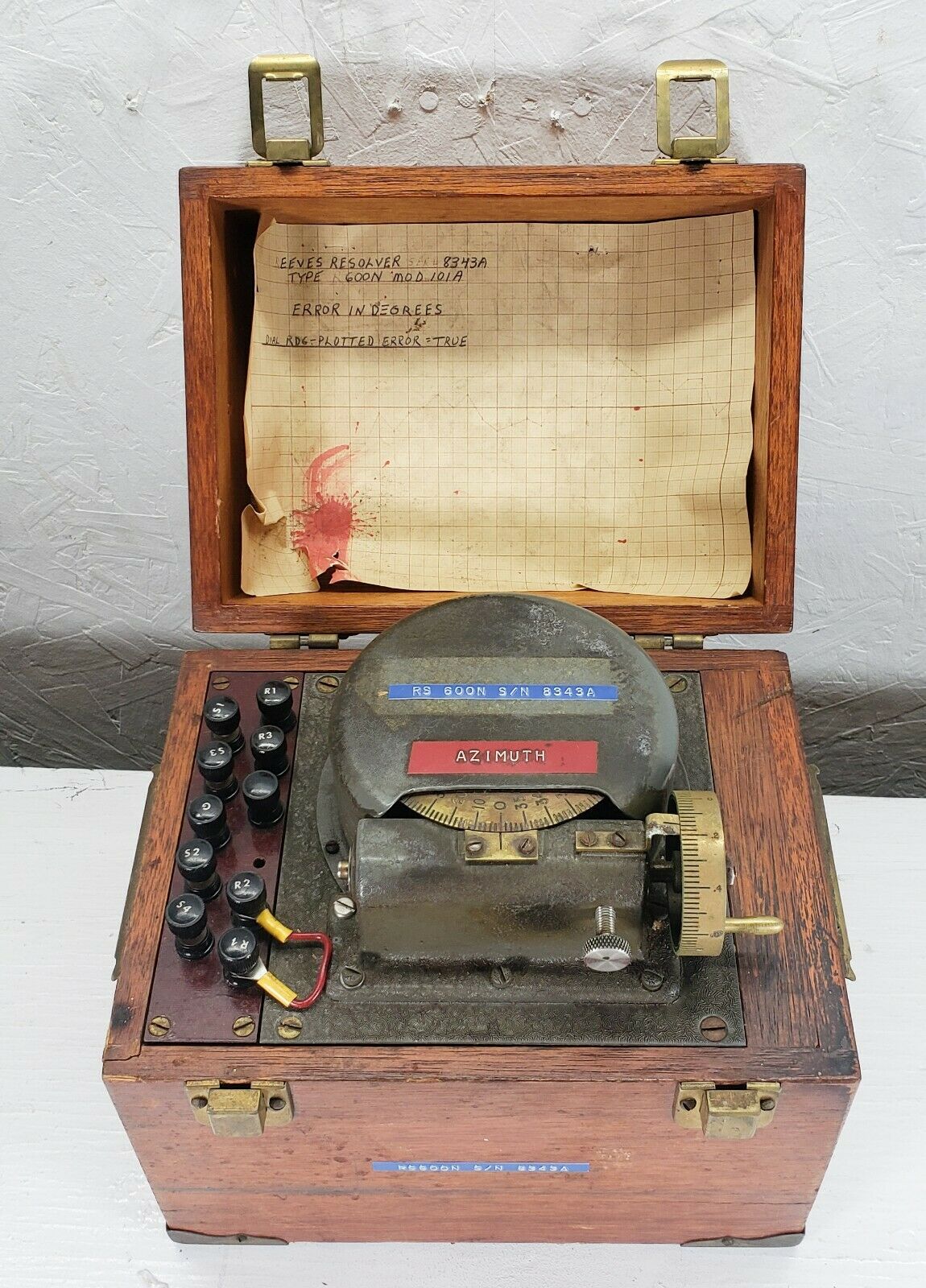

Hello everyone,
I came across this at an estate sale. With some limited research, it seems like it might have something to do with guided missiles or satellite trajectories. The writing says: Reeves Resolver RS600N. Does anyone have any knowledge about what this is? I've enclosed a pic...
Googling syncro and resolver will provide information.
These things were used for measuring angles and rotary position.
When I last came across one of these things, about 40 years ago, it was used for measuring the rudder position on a ship.
The thing in the box is basically a piece of test equipment which simulates the thing doing the measuring for testing the unit which displays the information, in my case the rudder angle.
I used to come across resolvers used in the older motion control servo motors for CNC machines.
Later replaced by the quadrature encoder.
