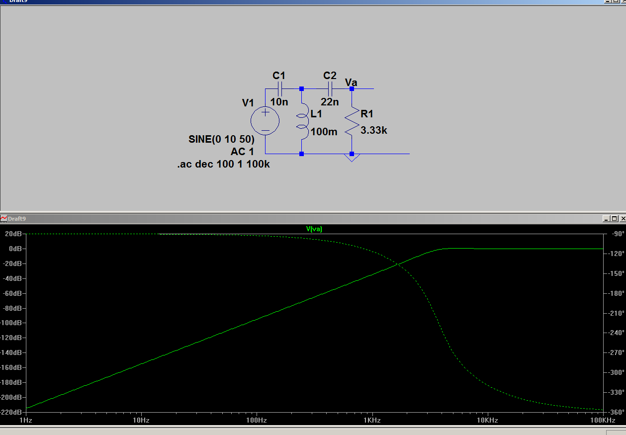

What is the cut off frequency of this LC and RC combination?
What is the method to theoretically find the cut off frequency of this filter(image attached) which has an LC and also an R? How do I look at: As an LC followed by RC or T network followed by resistor?
Attached the screenshot of Filter: -3dB CutOFF.pngpoint is around 3.4 kHz in the AC sweep.

It is a High Pass frequency filter. The capacitors impedance at s --> ∞ is zero and the inductor impedance is ∞ at s --> ∞ (|va/vi| (at w --> ∞) = 0dB).
So the -3dB happens at |va/vi| = 0,707

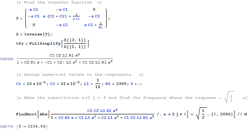

What tool did you use to compute this? Also I need to brush up my knowledge of Laplace Transforms since I am not able to yet get the Matrix you have in your answer..
And is there a way wherein Wolfram|Alpha can be used? What do I input though?
If the 3 nodes along the top of the circuit, left to right, are labeled V1, Vx, Va, you can write the 3 node equations with a TestCurrent of 1 amp applied to the input:
(V1-Vx)*(s C1) = TestCurrent
(Vx - V1)*(s C1) + Vx*(1/(s L1)) + (Vx - Va)*(s C2) = 0
(Va-Vx)*(s C2) + Va*(1/R1) = 0
Collect terms and you will have:
V1*(s C1) + Vx*(-s C1) + Va*(0) = 1 The 1 here is the test current.
V1*(-s C1) + Vx*(s(C1+C2)+1/(s L1)) + Va*(-s C2) = 0
V1*(0) + Vx*(-s C2) + Va*(s C2 + 1/R1) = 0
Solve these equations for V1, Vx and Va using whatever method you like. I inverted the matrix of coefficients and the voltages V1, Vx and Va are the first column of the inverse; columns 2 and 3 are not needed. Form the expression Va/V1. Substitute numerical values and the rest follows.
