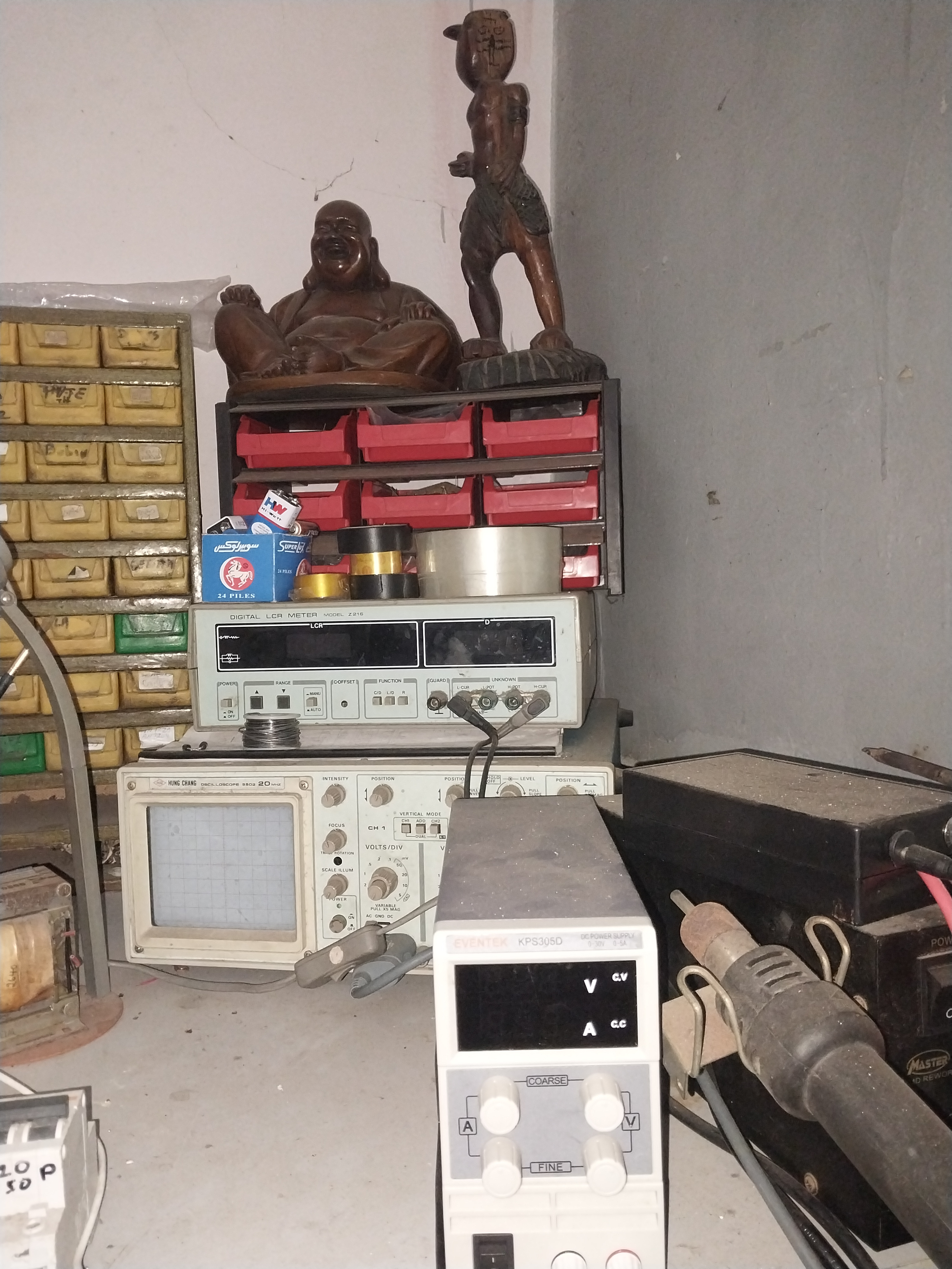

Yes i also got one in 2014 , hung chang 20 mhz Korean. But now it is just sitting there useless.
