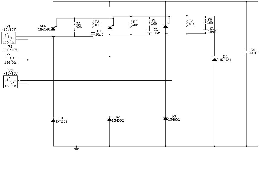

I asked becaused, I have a circuit with 10nf capacitor and 100ohms in series with each other connected to the gate of a silicon controlled rectifier (SCR). I want to know the purpose of this. The AC sine wave is inputted into the circuit.

In this case it is used to provide a pulse of charge of relevant size and the appropriate time to fire the Thyristor.
In this case it really isnt a decoupling capacitor
in some cases, a resistor and a capacitor connected in series makes a clock source, but not a clock itself. These two components alone, when their values are multiplied will insert a delay into the circuit. It may not necessarily be a start-up delay, but it is a delay in an electrical sense.
Maybe the author of the circuit is trying to incorporate some delay in feeding the voltage to the SCR.
What exactly does this circuit do?

Thanks for replying. What do you mean by "appropriate time to fire the Thyristor?" Dooes the series capacitor and resistor cause a RC time constant for firing the Thyristor? Can you explain a little further in detail please?
This is a power managment circuit for controlling how much power is delivered to the load 1kohms. Here is how the circuit actual looks. I do understand the need for R5, R1 and C1. I believe R5 limits the small current flow from triggering the SCR until the positive peak of the input reaches a certain amplitude. I think. help me out. Thanks

Well, you are being schooled on clock pulsing and other topics by other posters as to the specifics of your circuit, but, I THINK the best way to say it is, as far as decoupling goes : If you decouple something, you detach it, right? Like, if you have two pieces of pipe, you can couple them together with a union, and decouple them by removing the union.
...So, in electronics, circuits can be coupled and decoupled as well. I am not the best at explaining, so bare with me. If a capacitor is put from an input pin of a solid state device to ground, it is "decoupling" the IC or transistor from unwanted noise. Caps PASS Ac, and reject DC, so unwanted AC will go to ground. Depending on the VALUE of the Cap, desirable AC wil not go to ground, and allowed to go to the input of the device. This is called "band-passing", good frequency bands are rejected from ground and "passed" to the input and bad ones are pulled to ground. remember, caps only pass AC.
...Coupling capacitors work the opposite way, they are installed between two components and couple them just as the pipes are coupled with a union. They "promote" the passing of good AC signals, and stop DC from going to device inputs. The DC is rejected, and pulled to ground by either a resistor or choke.
I hope I've explained this OK, maybe someone elso could elaborate or edit my explanation ?

Thanks for the explanation: it is becoming clear. I will analyze futher.
