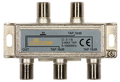

Take a look at this wierd thing. An 18 dB tap with ~1.8dB insertion loss.
The loss is dependent on frequency for one. Coax has a loos per foot with frequency. RG-6 is better than RG-59.
So, if I had 18 db coming in, I'd have 16.2 dB (18-1.8)coming out and I could add another tap and another.
Every tap I use. I lose 1.8 dB. The signal to my set sees 18 dB less than what's coming in.

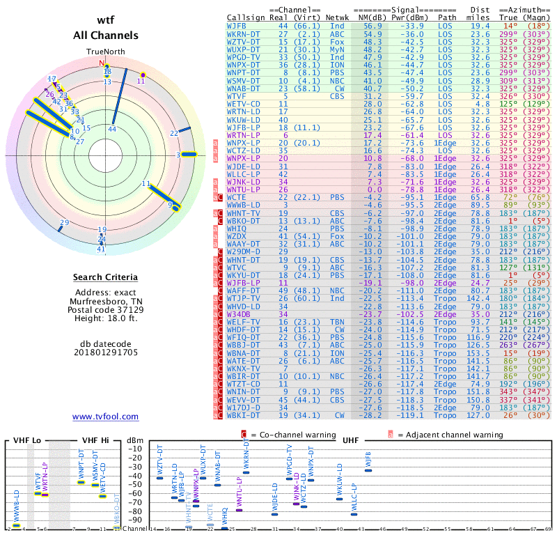

TV fool shows my TV stations all in - db what does that mean row for signal Pwr ?
There is another row of NM db what is that?
Kiss : IF you want to pass that 18dBmV = 7.94 mV signal trough the device described in post #11
Applying the signal to the left top port
and exiting the signal trough left bottom port 'out', the insertion loss of the device pictured being 1.8 dB; yields 18 dBmV minus 1.8 dB = 16.2 dBmV for a signal within 5 to 1000 MHz per specifications.
If instead; the signal applied to the top left port 'in' is exiting trough the bottom right tap '18dB', the level takes 1.8 dB loss for insertion of the pictured device and also an attenuation of 18dB from the device internal divider resistive? network for that attenuating port. Summing 1.8dB and 18 dB = 19.8 dB
Now the signal outputted at the right bottom port is the original 18 dBmV minus 19.8dB = minus 1.8dBmV = -1.8 dBmV
-1.8dBmV is 0.812 millivolts.
Then, the original signal of 18 dBmV applied has been attenuated by 19.8 dB trough the pictured device which is the same as from 7.94mV to 0.812mV if within 5 to 1000MHz per specifications.
Hi.
NM (dB) means noise margin expressed in decibels.
A power level expressed in dBm has reference to one milliwatt on a 75 ohm impedance load.
(Zero dBm equals 1 mW.)
The signals shown at your 'tvfool' chart showing around minus 100dBm means 100.0 e-12 milliwatt or 0.0000000001 mW of power reaching your 75 ohm loaded antenna at your location for that distance from the broadcast station.
