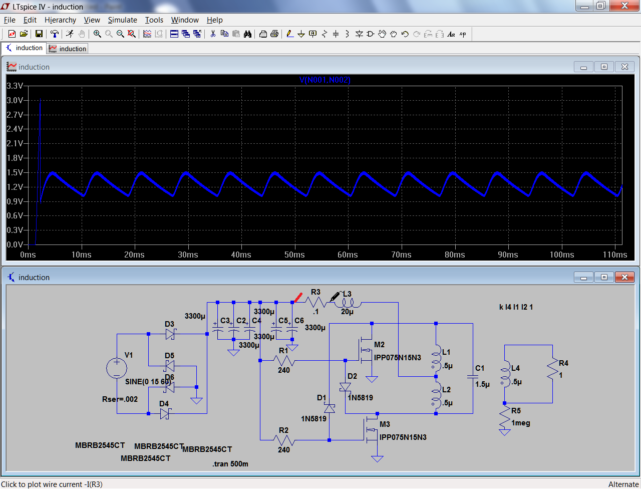

If you can make about a 0.1 ohm resistor and place it in series with the inductor as shown you can then measure the voltage drop across it to find the current with various loads. Then we can try to match it up to spice to see if we can "scope" it.
I don't think it is the high frequency getting to your caps, but the high ripple current (the current put into them by the transformer and taken out by the circuit).
Either way we would know a lot more if we knew the DC current from the supply under different loads.
PS> The resistor needs to be at least 20 watts, so maybe several larger values in parallel.
