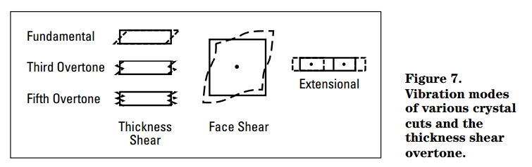

It certainly sounds a crystal is toggling between fundamental and 3rd overtone.
6MHz is possible to make as a 3rd overtone
The cylindrical crystals tend to be watch type 32kHz
It suggest that the 6MHz Xtal Oscillator is at fault. Since it would have the CMOS gate and caps internal, it should not be sensitive to load capacitance or orientation. 3rd overtones are usually thickness regulated to control and sometimes helped with an LC bypass.
