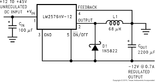

This is the simplest circuit I can find: https://encrypted-tbn0.gstatic.com/...xNy8UtPHLozJ1Z3Xe9i2HaryAlZ82EvTPBzDuHA2SGKTj
The IC switches pulses of power through the inductor. When the IC output switches off, the current in the inductor tries to maintain and the left hand side goes negative relative to ground, so the current passes through the diode and adds some charge to the capacitor each time.
