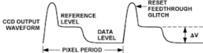

I have another related problem:
My work is based on FPGA and VHDL. analog output of CCD sensor ,observed on oscilloscope screen, has below typical shape. but it acts reversely. that is, the differences between the reference level and data level will be max while dark source and it will be min (near to zero) while max of intensity of light source!!! I don't know why it act reversely...
Moreover, after the converting of analog to digital, the observed output of AFE is noisy in both states of dark source and light source.
can you help me?
In TV, Black level is always closest to reference after negative sync tip with positive 100% IRE white
Here you show the same except everything is inverted. This is how TV carrier was modulated in old analog days with sync tip and black for the strongest carrier
