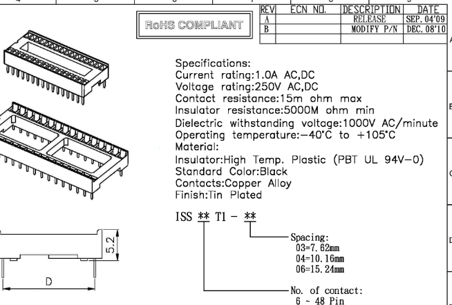

We are dividing down 390Vdc to 2.5V, then feeding this to a PFC control chip (UCC28070A) which is on a daughter PCB, through the below header and socket housing.......there is no current going through the header pin.....is this OK?....or should we put the lower divider resistor on the daughter PCB, so that at least a few 100 microamps flows through the header connector? (to "wet" the contacts).

The contact material of the header and socket should to the same.
The header is gold plated, the socket tin.

Just use tin for both side of the connector. It flows under pressure and forms a gastight connection; no wetting voltage needed.
(No good quality gastight connector should need wetting, that's normally a thing with switching contacts - but there may be offsets from different materials).
I agree, he's over-thinking things again - wetting is for switch (and particularity relay) contacts - a connector is likely to be plugged in, and possibly never disturbed again, and even if it is, connectors tend to have a 'rubbing' action as they go in place.

Frequent vibration at reasonable levels will likely improve contact connectivity. The problems with both connectors and switches are when they are not disturbed for long periods, so the non-contact exposed areas tarnish or corrode etc., then something disturbs the contact position and it moves to an area of tarnish.
That is unlikely if not impossible with tin plated connector contacts, as the metal flows with any movement.
It is quite common with silver switch contacts, and consumer "shiny" connectors that are hardly gas tight.
Note that "gas tight" is nothing to do with sealed connectors, it just means the contact design and mating point pressures are high enough to prevent oxygen penetration, so no tarnish or corrosion.
