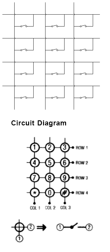

i bought a matrixed keypad from rapid electronics which is 3X4. it only has 7 pins on it, so no +V?? how do i use it? here is a picture of the actual keypad, the one i have is the one on the far left.
you can see there are only 7 pins on the picture.
here is the datasheet, which didnt help me at all to be hounest.
does anyone have any ideas how to use it?
picaxe, using a flowchart, so im trying to think of a way of doing it with a flowchart. also i have used up all of my picaxe chips outputs so i dunno how i can do it?

well i have never useda keypad before, i thought you would have connected it to high and have 7 inputs and work out what button is being pressed by the row input and the column input. so sorry about the title but i didnt realise it at the time, thats why i put the question mark at the end of the title. anyways i think i have fixed my problem, i have to change some of the inputs on my picaxe chip to outputs which can be done in basic code.

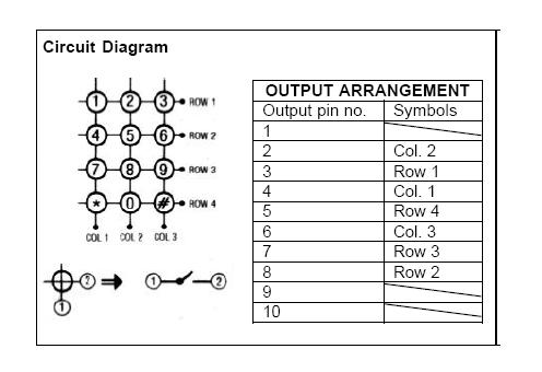

also another thing i want to know about is the number of the pins, for example my kepday has two holes either side of the metal pins, and on the datasheet it says that output pin2 is column two, and output pin 3 is row 1. how do i know which pin is 2 and three? is pin 1 on of these holes? which pin is pin2?
Grab a multimeter and throw it on resistance checking, and then you can press keys and see what output does what.
There are many keypad matrixes’ out there, and sometimes you can’t just use someone else’s routine to make your own program.
But they all share a similar approach - make one group inputs, the other outputs, and set one output high, check if any inputs are high (indicating a key press)
Here’s my example;

Nigel Goodwin said:
Check the hardware my tutorial uses - there's no ground or +ve connection to the keypad, it's multiplexed.

Like he said, meter on ohms! - or check the pictures in my tutorial! (I used the meter on ohms to find which was which).
I urge you to take a look at the datasheet, it's pretty obvious when you think about it.
I've quickly illustrated it for you.
You only have seven pins, and they are numbered from the left 1 through seven. Refer to your datasheet or the attachment below. Edit: actually, the datasheet calls out 2 - 8, but its the same.

thanks! and im using a 28x
Good deal, that should work out okay.
