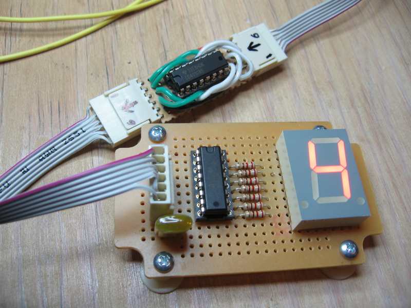

OK, the hex buffer did it! I don't know whether I did this right, but it works: I can now drive my long cable off the end of the shorter (60cm) one I was using before. That's more than I was hoping for in a first test.
I used a 4010 non-inverting hex buffer, 'cause that's what I had around.
I hooked up Vcc from the main board to Vcc and Vdd on the 4010 hex buffer, put GND from the main board to Vss on the 4010, and put the signal lines through 4 of the buffers. Tossed on a couple of headers and I've got a display cable booster.
Anyway, I've attached a shot of the prototype display board displaying a "4" over more than a meter of ribbon cable, which qualifies as a success to me. (Of course you can't see all the cable but I'm really happy about this so trust me--it's there). For the record, before the buffer it would have displayed a "4" with no leg--a BCD 12, which the 74LS90 shouldn't produce at all when wired for BCD counting.
Thanks for the help and for the backup on the ribbon cable capacitance hypothesis. I don't have the gear to test capacitance to that kind of tolerance so it's all down to knowing the rules, at that level.
Good news.
You would need to place the buffer close to the outputs of 74LS90 in your final design, not at the end of a 60cm cable.
Remember to also tie the inputs of the remaining two unused buffers on the 4010 to either ground or +V. Their outputs can be left unconnected.
A capacitor on the buffer would not make a noticeable difference as the logic levels are stable and no clocking is involved. The 74LS47 will never display a wrong result in this case.
