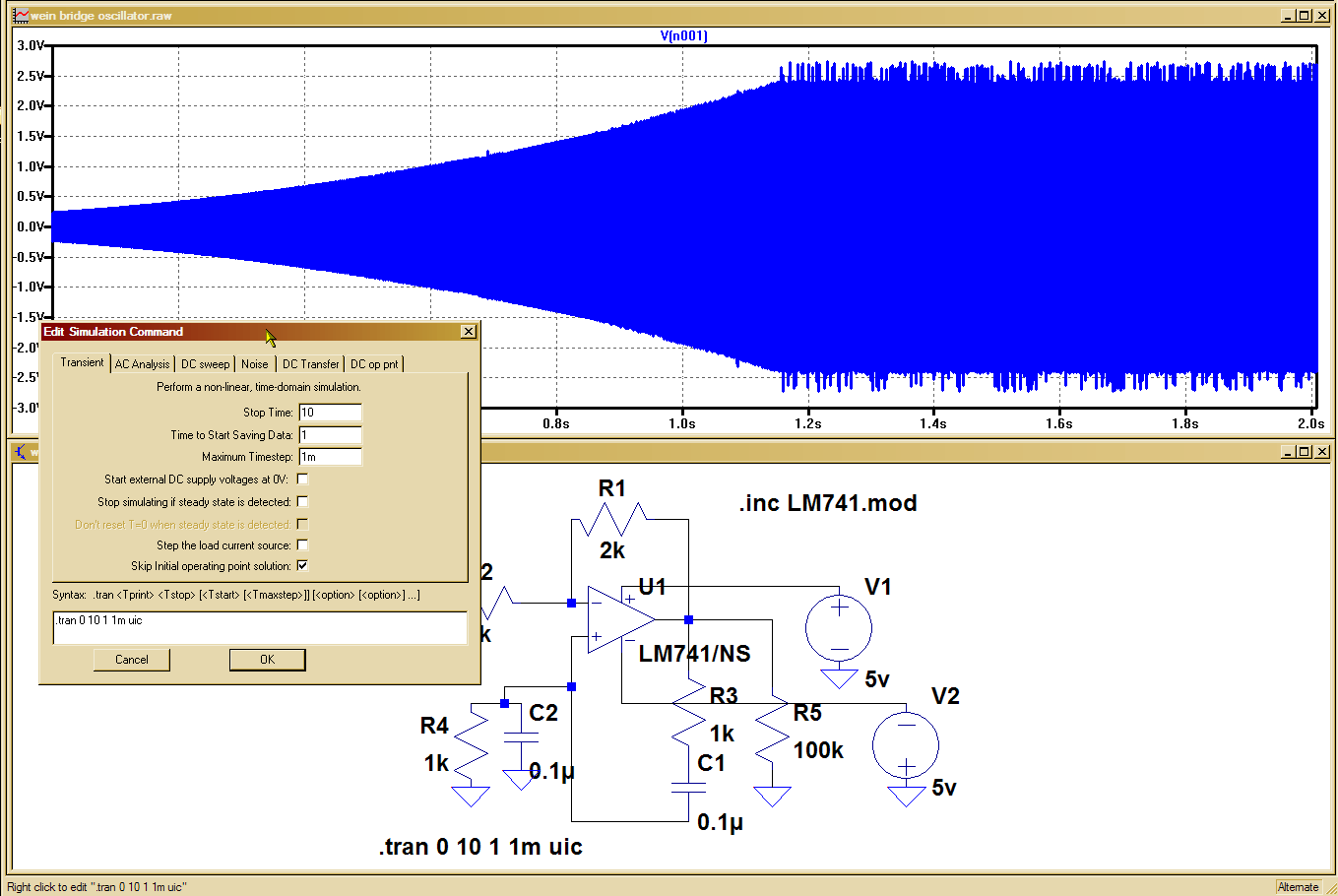

i have posted simulation.
what is wrong with this circuit ?
  • wein bridge oscillator.asc
You had time step of 10 seconds, look at my settings.
@ericgibbs,
Can you please indicate the criteria that decide the 2sec or so settling time for the Oscillator to stabilize
ok you have entered stop time 10 and simulation is stopping at 2s
in FFT graph view, its freq. is 1.111 Khz , how to calaculate freq. is it same f=1/1.38RC
@ericgibbs,

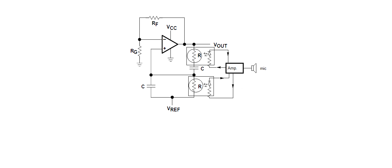

here is the schematic.
i think it deepnds on slew rate on how much this op amp can change voltage freq.
we can use high slew rate op amp , if that is not possible then we can use this FM modulator for lower frequency, not necessarily for audible range. !
Does LTspice has any component like this voltage dependent resistance ? i want to test this ^^
https://www.instructables.com/id/Make-a-Voltage-Controlled-Resistor-and-Use-It/ this site is proposing same thing

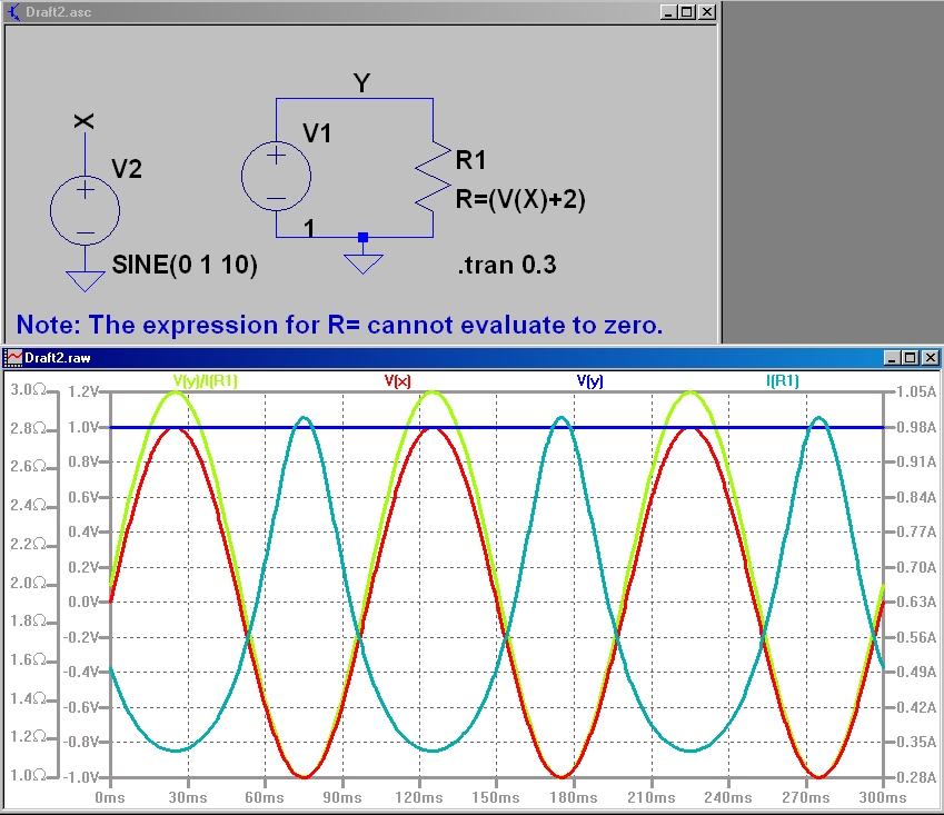

You could use a behavioural current source.
ok is it voltage dependent resistor or current dependent resistor, i think both are same but have analogy.
Or behavioural voltage source
If the dependence is such that the resistance is proportional to voltage then (applying Ohm's Law) the resistor is equivalent to a constant-current source. What sort of dependence did you have in mind?
Yes, a behavioural voltage source could be used.
see when we speak in microphone current is generated in coils , so i will have to current dependent resistors.

hi neptune.
You could easily use a stepped 'potentiometer' model
is stepped 'potentiometer' voltage dependent resistor ?
is it available in yahoo LTspice ?
Its not a VDR, put a potentiometer that can have its value stepped from 0.01% thru 99.9%, available from YLTS
