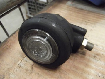

Having an automotive background I'd use something along the lines of a vehicle light as an enclosure, rubbolite trailer side lamps are ideal.
