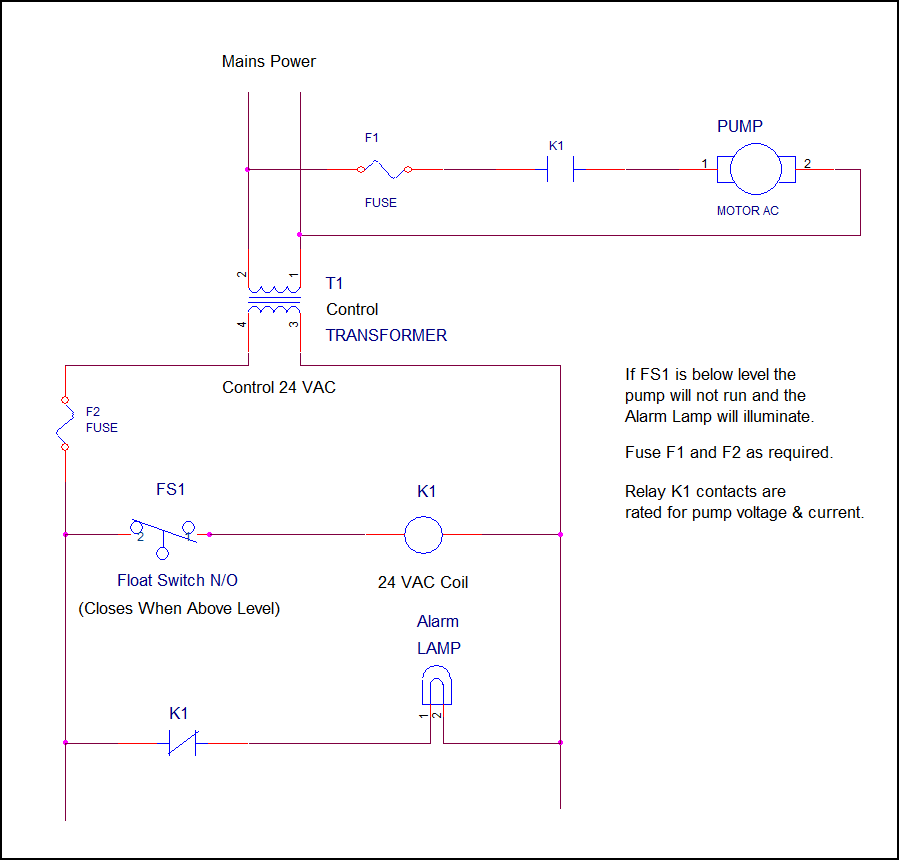

A cheap and reliable way is using a water level switch as mounted in laundry washers.
Many of them are adjustable.
Adjust the switch to be pressurized when water leaves the end of the pipe and activate it with the pump.
As soon as the pipe is interrupted the pressure drops to zero which makes the switch open, and hence make a usable signal to switch off the pump.
Boncuk
I would use a circuit around ronsimpson's suggestion or Boncuk's suggestion. I just see using line pressure as a problem. Float switches or the pressure type switch Boncuk suggest just seems a simple and more reliable solution. I would also keep my control voltages low around 12 or 24 VAC.
Just My Take
Ron
