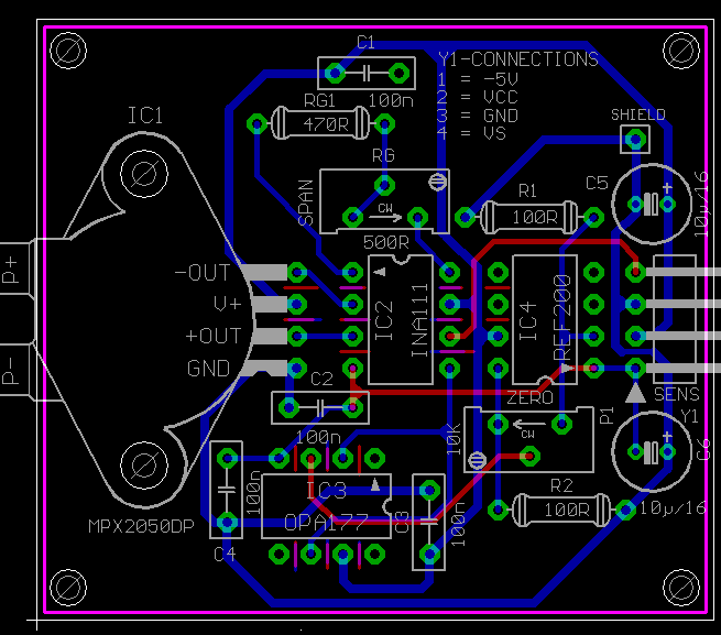

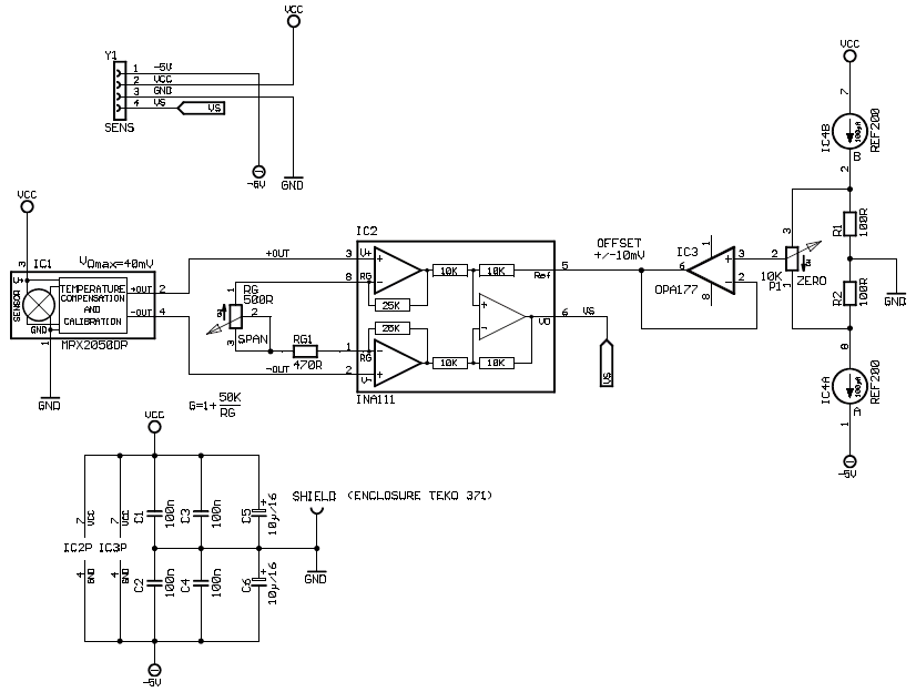

Here is a sample circuit for a precise differential pressure transducer.
Boncuk
I'm not clear how a differential pressure sensor can sense water level. If inserted in the pump flow-line it will sense mainly (only?) the pressure drop due to flow resistance of the pipe, i.e. a function of the pipe diameter, pipe length, flow-rate, and fluid viscosity.
You don't install it in the pump flow line, you install it in the well, so that it measures the head of water above it.
You may also be better off with an absolute or gauge pressure sensor, then you don't need hoses down the well -- just the signal cable.
