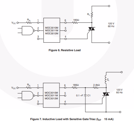

This is the circuit that I will use for the phase firing.
Thus, with negligible inductance, does it mean that I can use the circuit form figure 6 instead of figure 7?
it's best NOT to connect your control circuits directly to the power line. an optoisolator or a Solid State Relay (SSR) are the best approach. there's enough thermal inertia in the heater that a simple temperature controlled on-off system could be used. on the other hand, a very inexpensive way of controlling it would to be the use of a standard light dimmer (200Watt or higher). btw, what is the heater made of? if it's aluminum, you might not want to immerse it directly in etchant, as the ferric chloride attacks aluminum at a much higher rate than copper. perhaps a sealed steel tube around the heater and the empty space filled with water would work as a buffer.
