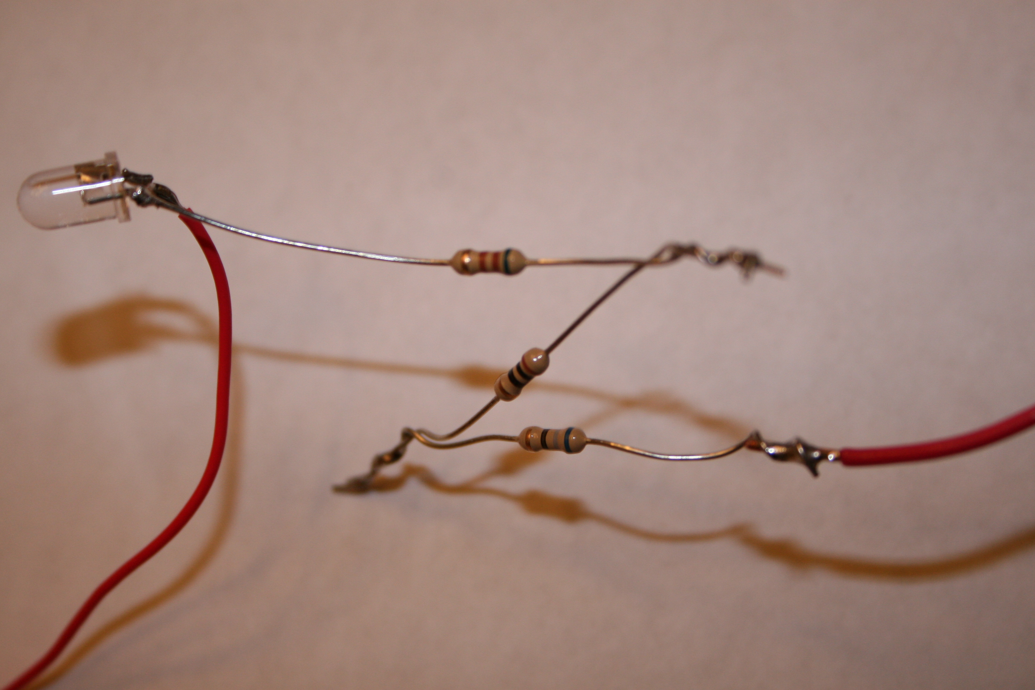

thanks, i attatched an image but it looks like its not showing up, i will try again, there are four red LED's, brightness isnt critical, id rather be on the safe side, so after you have read this, does it sound safe and good to go?
this is the set of resistors i have
Looks to me like you have 68 (blue-gray-black-gold), 10 (brown-black-black-gold), and 520 (green-red-brown-gold). Is that correct? That would be 598.
Please note that I'm recommending that you don't need to get the exact value, just use the nearest value or the next higher one. A 680 ohm (blue-gray-brown-gold) is close enough and a lot fewer connections to give you trouble.
is the only problem with more connections just more of a chance to break? because i dont realy mind having so many connections as long as it will work
Will it work yes is it the best way to do it no. but also make sure none of them short eachother out. It may blow your leds and all your work will be for nothing.
