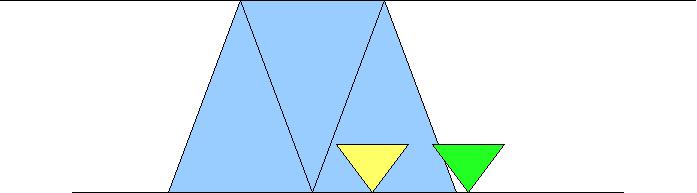

Not to say that I am right. But I did some sketches to convince myself that it could work. The IR LED is non diffused. There is bound to be some scatter and reflections but I think the majority of the light should follow the lines of the cone.
I am thinking of this like a very low resolution digital camera. Each photo-transistor can only sense light that strikes it, It can see everything it its cone/field.
The graphic shows what I mean. The light from the LED hits the edge of the right (green) photo-transistors cone but does not hit the transistor itself.

3v0, interesting idea, but, big issue is fighting the ambient light. if you use modulated signal and IR receiver then you will solve the ambient light problem (mostly) but then you cannot measure the intensity of light on each receiver (as all those I saw have digital output). with receivers stacked close to each other, I do not see how you will achieve resolution you need. I still think that sonar approach would be better. The ultrasound transducers are not expensive, the sound is quite slow so you can have pretty good resolution even with 4MHz uC. If you mount send/receive capsules on a motor and swing them around (180 degrees should suffice) you can get pretty good idea on what is the exact position of the wall related to the bot. I'm working on the exactly the same idea at the moment and have it all "work" in theory, but had no time to drive to the shop and get the us capsules so I can actually try the idea out.

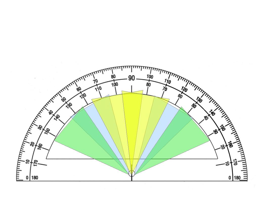

I have not settled on a single approach. I need to teach students how to do this next year and intend to present several methods that work. When class starts I will need several of robots equipped with maze capable sensors so keeping the cost down is an issue.
My original idea was to use little SMD PTs (photo-transistors) to form a strip of sensors. They are only about 1/10th inch wide so they can be packed together. The PT's could be mounted in the bottom of a flat black U with the open side facing the wall to reject much of the stray light. I like the idea that this sensor provides an angle but it is starting to look too complex for what it does. Just the same it is interesting. Some of the dsPIC33's have 24 and 32 analog inputs. That and the massive processing power could be fun.
--------------Slightly different IR sensor project. -----------------------
I built a PCB with a single IR receiver and 6 IR LEDs. It was not intended for wall following. The idea is to use overlapping IR LEDs to detect objects in an arc ahead of the robot. Each LED overlaps it neighbor by 1/3 so that you end up with about an 120 degree arc with 11 detectable zones. The beam width and placement of the LEDs need tuning but the diagram shows the idea. The arc needs to correspond to the Sharp sensors sensitivity area.
I need to do the variable resistor bit you were playing with but have not yet made any provisions for it on the board. I figured I would get the basic detection working first and then experiment to see if I could get the variable power to the IR LED working for range detection.
This sensor was not intended for use in a maze but it might work if the power level range detection thing works close in.

What sensitivity/(distance resolution) did you get? What is the shortest distance you could measure?
EDIT: Lost attachment. I am not a big fan of the pivoting motor mounted sensor.
