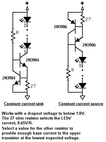

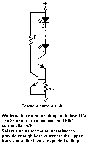

It sounds like you need the radio's voltage to be regulated at 3V with the LM317, but need to operate the LEDs at the full supply voltage for brightness. Then use a constant current sink or source for the LEDs instead of a simple current-limiting resistor and their brightness will be the same with both a new battery and an old one. :lol:

If that schematic you last posted is a current sink circuit, is it possible that I could rearrange it in such a way so that it works as a constant current source with only one output and +ve (and -ve/ground if required)
If I can get the same current output with voltage input in the range of 3 to 9 volts, then I'll be happy.
Sure it can be a constant current source. Just use PNP transistors and swap around the parts like this.
The constant current sink and source circuits keep the current constant with a supply as low as 3V if the LED forward voltage is about 2.0V or less.
But your LM317 regulator isn't a low-dropout type so will dropout and lose regulation when its input voltage drops to about 5V or 6V and lower with it set for a 3V output. :roll:
The dots are more LEDs in series. You can put as many LEDs in series as you want. Since they are in series, their currents are all the same. The supply voltage must be at least as high as their total voltage drop, plus 1V minimum. If the voltage or current is too high then the driver transistor will melt. :lol:
why are two transistors necessary? How do the transistors make the output a constant current even though the voltages vary?
He, he. They do it with majic! :lol: :lol:
Remember how transistors work? Look at the current sink circuit:
1) The upper transistor conducts because the resistor R supplies it with base current. The lower transistor doesn't conduct because its base voltage is very low.
2) When the current in the upper transistor exceeds about 20mA, then Ohm's Law says that about 0.54V or more is developed across the 27 ohm resistor.
3) With about 0.54V between its base and emitter, the lower transistor conducts just enough to shunt to ground some of the base current of the upper transistor, so it conducts less.
The circuit will stabilise at about 20mA regardless of the supply voltage if the rules are followed.
Analog ICs are full of constant current sinks and sources. :lol:
I'll explain based on the circuit on the left.
Theoretically, you could get away using only one transistor, but you wouldn't be making a very good current source, because it would vary greatly with the load you'd be applying to it.
When you analyze transistor circuits, one of the main things you need to remember is that in the active region the voltage drop from base to emitter (output with an arrow) is around 0.6V. What happens in the circuit is the following:
1) the transistor on the lower left (the one with grounded emitter), causes 0.6 drop accross the 27 ohm resistor, and that drop is relatively constant (this gives you the stability), the second transistor (the one with collector connected right to the LED), isolates your current source (the 27 Ohm resistor with 0.6 V accross it), from the load (LED's). It does it thanks to low impedance looking into the emitter, and high impedance looking into the collector.
Another way of looking at this is that the transistor on the left, provides you with a stable biasing for the transistor on the right. You could get away with replacing the transistor on the left with another resistor such that the Voltage at the gate of the first transistor due to the resulting voltage divider, would 1.2 V, and you'd still end up with 0.6 V accross the 27 Ohm resistor.
No it doesn't. Current doesn't come out of the transistor's base and go down into the 27 ohm resistor.
the second transistor (the one with collector connected right to the LED), isolates your current source (the 27 ohm resistor with 0.6 V accross it), from the load (LED's). It does it thanks to low impedance looking into the emitter, and high impedance looking into the collector.
Huh? This transistor supplies the LED current, not the 27 ohm resistor.
Impedances have nothing to do with it.
You are sort-of correct. :lol:
I never said the current comes out of the base. The current comes out of the collector of the transistor on the right side.
Also - you were wrong in stating that the transistor on the left is not conducting - it is.
Impedances have everything to do with it - even more so, because you are using such a small resistance in your degenerative emitter feedback.
