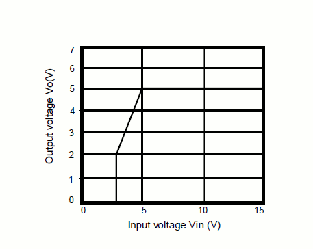

The LM2931AZ5 is one of may favorite regulators. This is the first regulator I reach for when 100mA is enough.
It will not conduct backward. I use the junebug to power boards with this regulator even with the regulator unpowered.
The dropout is low enough that 5V in will still provide a voltage that is nearly 5V when output current is low. As current nears 100mA the voltage drops off to about 4.5V. I think (should check) that most of my pic circuits run at about 4.85 when powered through this regulator from an already regulated 5V source.
